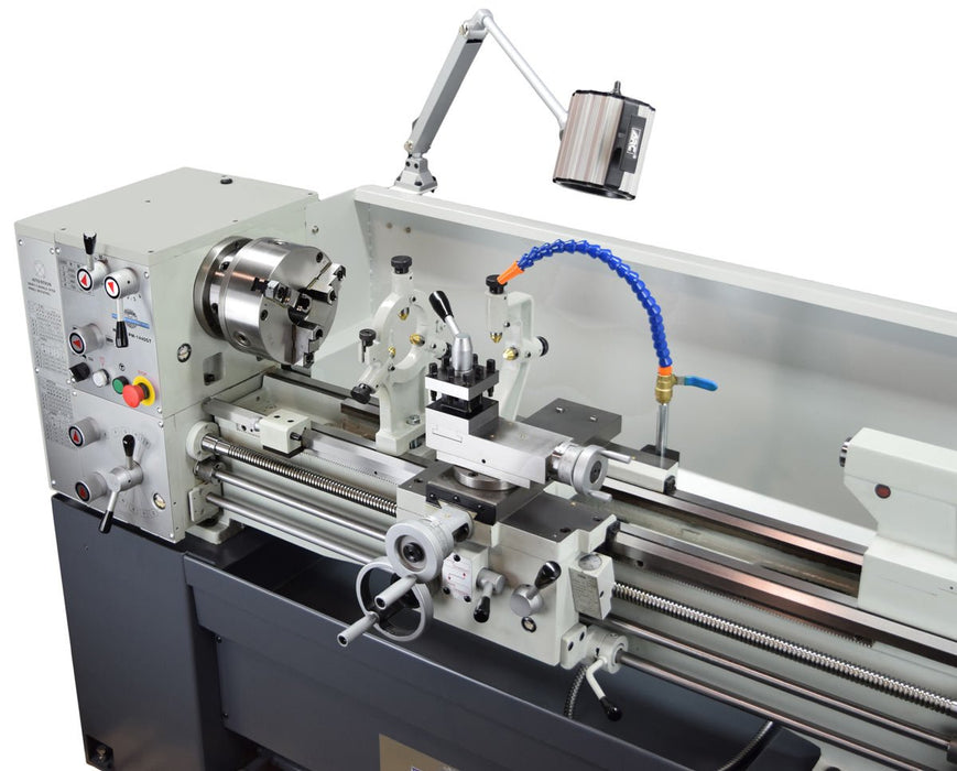

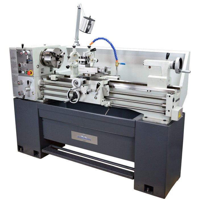

PM-1440GT Main Features
  • 3 Phase Model option uses a standard 3 Phase Motor and Power Input
  • 1 Phase Model option now uses a Hitachi VFD driven main motor - This model still only needs 208/240V standard 1 Phase Power in, so this machine operates on standard single phase power. But internally, there is a VFD Driving the main motor. This results in extremely smooth operation, completely eliminating the use of a single phase motor. This is a brand new feature for late 2025! (This is where the cost difference comes in with this option over standard 3 Phase)
  • Large 2” Spindle Bore clear through spindle for through-headstock work
  • Short Spindle Length, only 15-1/2", perfect for gunsmithing work
  • All gears and shafts in headstock hardened and precision ground for long life and extremely quiet running
  • FC-25 Meehanite Cast Iron used for rigidity and vibration dampening
  • Removable Gap for larger diameter work
  • Slip Clutch on feed rod, to help prevent overloading damage of feeds and allow the use of a solid micrometer carriage stop for repetitive work
  • High Precision Tapered Roller Bearings used in spindle, for the ultimate in long life, high precision, and best surface finishes. Guaranteed Run Out +/- .0001" for ultimate precision
  • Inch AND Metric thread cutting ability is a standard feature
  • Splash oil bath lubrication in Headstock, and Apron, for efficient lubrication, and long life, yet simple and reliable, maintenance as with oil pump lubrication systems. Also no risk of losing oil flow to expensive parts as there can be with pump lubricated systems
  • Only Extremely High Precision Japanese Spindle Bearings are used, NACHI Brand at this time
  • Locking Tang in tail stock
  • Longest in the industry, 5 Year Warranty!
PM-1440GT Standard Accessories
(Machine is available in either single or 3 phase, select from drop down when ordering - Single Phase machine is now driven by a Hitachi VFD, new for late 2025!)
  • Complete Base with Chip Tray

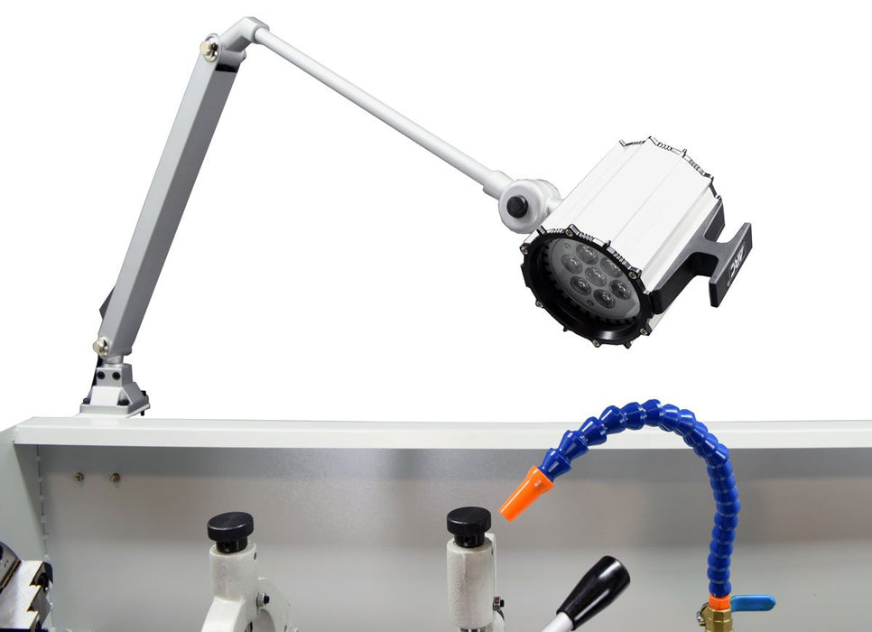

  • L.E.D. Work Light
  • NACHI (Japan) Spindle bearings, with +/- .0001" Max Spindle Runout
  • D1-5 Quick Change Spindle Mount
  • Back Splash Guard
  • Reducing Sleeve for Headstock Center
  • 4 Way Tool Post
  • Headstock Dead Center
  • Tail Stock Dead Center
  • Thread Chasing Dial (4” Travel Thread Dial, for easier inch thread cutting)
  • Feed Rod Clutch (To prevent overloading and using carriage stops)
  • Everything Needed for listed Inch and Metric Thread Pitches
  • Coolant System
  • Foot Brake
  • Belt Cover Interlock Switch
  • D1-5 Face Plate (12" Diameter)
  • (6) Pcs Cast Iron Leveling Pads with Bolts
