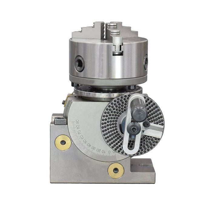

  • Head tilts 10 degrees down, and 90 degrees in the vertical direction, (Chuck pointing straight up) so it can be used for any angle needed
  • Quick indexing feature, for fast indexing without dividing plates, in 15 degree increments (24 positions) makes quick work of simple tasks such as machining hex shaped bolt heads

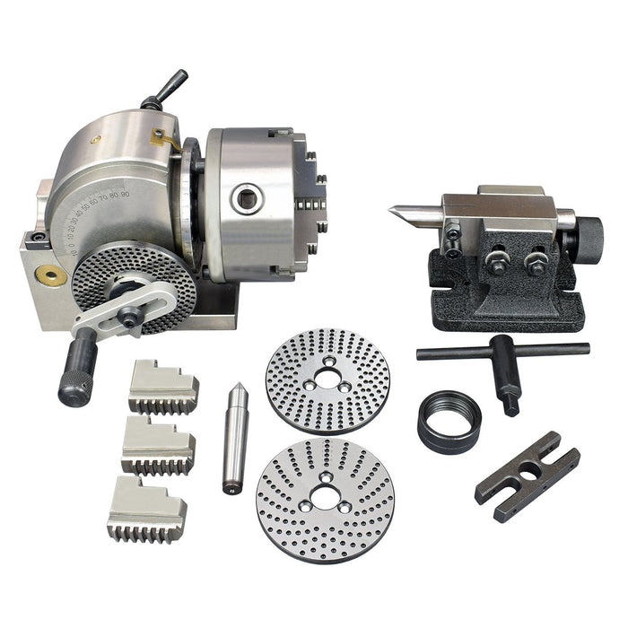

This set comes complete with everything as shown, as listed below:
Dividing Head
5" 3 Jaw Chuck, with inside and outside jaws, and chuck wrench
Adjustable Tailstock
Dividing Plates (3 plates Total)
Spindle Center
Dog Driver (For use when turning between centers)
