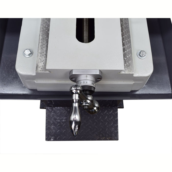

  • Hand Scraped way Surfaces for better oil retention and fit, which leads to ultra smooth, very accurate movements
  • One Shot Lubrication system is standard equipment, which also extends machine life, and reduces oiling times
  • High precision Inch Pitch lead screws, for ease of use and greater accuracy (10 TPI Screws)
