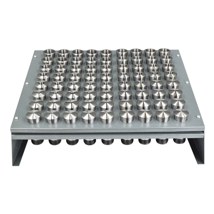

  • Rack Included, As Shown
  • 72 Pc Set covers all sizes, from 1/64 to 1-1/8″, X 64ths
  • Fits any machine / Accessory with 5-C Spindle Taper
  • Precision Ground Clamping Surfaces, max runout .0005"
  • Threaded Internally and Externally
  • Each Collet is marked with size for easy identification
  • Collets are Hardened and Precision Ground
  • Made from ASTM A29-93 Steel
  • Clamping Surface Hardened to 55-60 HRC
  • Spring Part is Hardened to 40-45 HRC
  • Guaranteed to Accuracy of Clamping to 0.0005" or less
  • 3 Year Warranty Against Defects
SKU 5C72PcSTD
  • 72 Piece set covers every size you could ever need, from 1/64" to 1-1/8", in 1/64ths increments
  • Rack included, as shown
  • Fits any machine / accessory with 5-C Spindle Taper
  • Each collet is marked with size for easy identification
  • Rack size is 15"D x 18"W x 9"H
