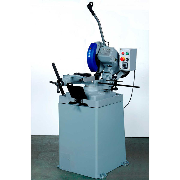

CS-315 Cold Saw, 12.5", Single Speed
Original price $2,399.00 - Original price $2,399.00
$2,399.00
$2,399.00 - $2,399.00
Current price $2,399.00
  • Operates on 220V Single Phase Power
  • Quick Acting lever for angle changes, can be done in only a few seconds
  • Quick Acting vise lever, for faster operation on multiple cuts of the same size
  • Miters 45 degrees, both ways (Left and Right)
  • Adjustable Work Stop with Inch/MM Readings included as standard equipment, for faster repetitive cuts
  • Coolant System is standard equipment
  • Heavy Duty Cast Iron Body for chatter free cutting
  • 5 Year Warranty!
$199 Flat Rate Shipping in the 48 US States – Any accessories ordered with machine at the same time also ship free of charge!
SKU CS-315
*CS-315 - ETA UNKNOWN AT THIS TIME
CS-315 Main Features:
  • 5 Year Warranty!
CS-315 Standard Equipment:
  • (1) Pc. 315mm (12.5") General Purpose Blade
  • Stand/Base
  • Work Stop
  • Blade Guard
  • Quick Acting Vise Handle
  • Coolant System
  • Operator's Manual and Parts List
