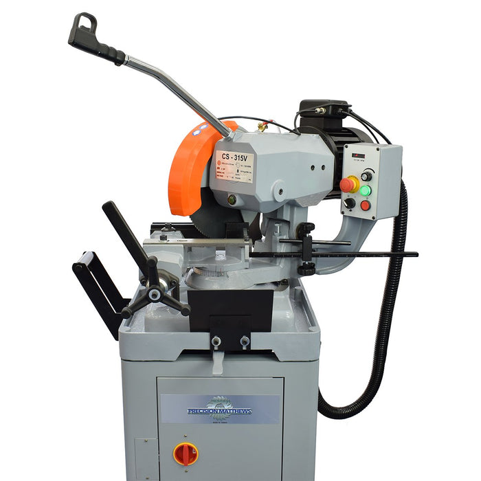

  • Operates on 220V Single Phase Power

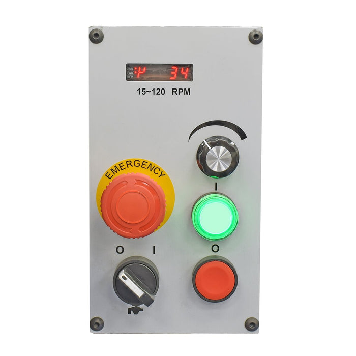

  • Variable Speed from 15-120 RPMs allow user to dial in blade speed to the job for even better performance
  • Quick Acting lever for angle changes, can be done in only a few seconds
  • Quick Acting vise lever, for faster operation on multiple cuts of the same size
  • Miters 45 degrees, both ways (Left and Right)
  • Adjustable Work Stop with Inch/MM Readings included as standard equipment, for faster repetitive cuts

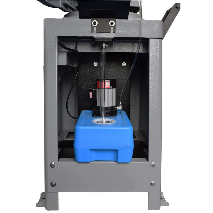

  • Coolant System is standard equipment
  • Heavy Duty Cast Iron Body for chatter free cutting
  • 5 Year Warranty!

CS-315V Standard Equipment:
  • 220V Single Phase Operation, Inverter drive variable speed
  • (1) Pc. 315mm (12.5") General Purpose Blade
  • Stand/Base
  • Work Stop
  • Blade Guard
  • Quick Acting Vise Handle
  • Coolant System
  • Operator's Manual and Parts List
