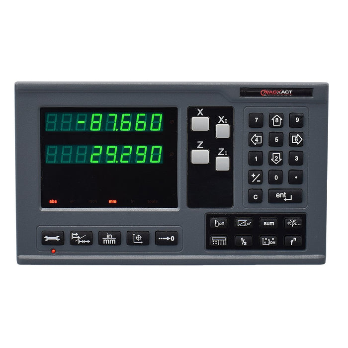

The MagXact by Precision Matthews 2 axis Lathe DRO is a dedicated Lathe specific digital readout housed in a compact, slim, high performance metal case.
Fully loaded with all the features you would expect including Radius/Diameter Function, Calculator, Tool-offsets, etc. This MagXact DRO Carries a 5 year warranty. Scale Sizing shown below under Description
SKU DRO-MAG-L-2ax-10x60
This MagXact by Precision Matthews DRO set is generally sized for a 15x54 to 20x60 lathe within the listed travels (such as our PM-1660TL) and will work with many other similar sized machines.
This Magnetic Lathe DRO is a dedicated Lathe specific digital readout.
  • Machine specific version
  • Magnetic scales and encoders
  • High resolution cross scale - .00005" (1Um)
  • Bed scale resolution .0002" (5Um)
  • Built in calculator
  • Radius/diameter function
  • One touch axis zero
  • Tool Offsets
  • Memory backup

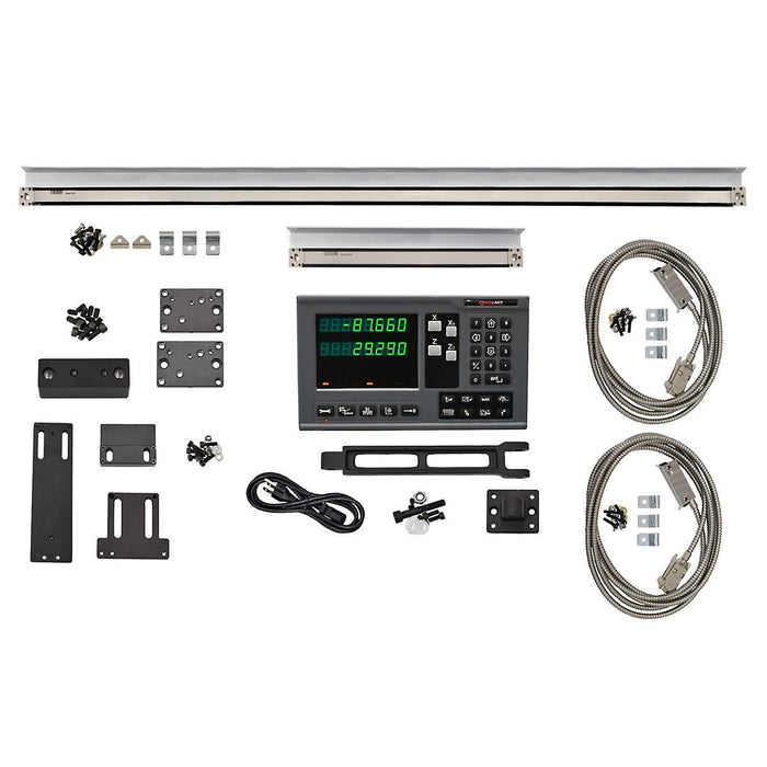

This DRO Set for Lathes, 2 axis, 10"x60" Travels, this set is complete with:
1. MagXact DRO Display, 2 axis, for Lathes, with Mounting Bracket and 110V Power Cord
2. 250mm (10") Cross Slide Scale, .00005" Resolution
3. 1500mm (60") Bed Scale, .0002" Resolution
4. Bracket/Hardware Set for installation
5. Manual
6. 5 Year Warranty
