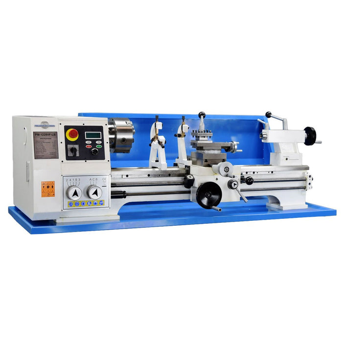

  • Operates on 110V Power, No special wiring needed
  • Brushless DC Motor, Variable Speed
  • Quick Change Gear Box, Many less change gears than other machines in this size
  • INCH LEADSCREW AND FEED SCREWS for even, easy measurements
  • POWER CROSS FEED, BOTH IN, OUT, and LEFT and RIGHT, and WILL CUT LEFT HAND THREADS TOO
  • Super Smooth and Quiet running machine
  • Large Spindle Bore 1-1/2"
  • Heavy Duty Bed Width (same width as most 12"x36" Machines)
  • Variable Spindle Speeds From 50-2000 rpm
$249 Flat Rate Shipping in the 48 US States – Any accessories ordered with machine at the same time also ship free of charge! (Will automatically calculate at checkout)
SKU PM-1228VF-LB
*PM-1228VF-LB - WILL UPDATE NEXT SHIPMENT ETA ONCE CURRENT STOCK SELLS OUT
*PM-1228VF-LB-w/2axDRO - WILL UPDATE NEXT SHIPMENT ETA ONCE CURRENT STOCK SELLS OUT
PM-1228VF-LB Main Features
  • D1-4 CAMLOCK SPINDLE MOUNT, with LARGE 1.5” Spindle Bore, Best in class for universal chuck mounting, and the ability to accept larger diameter work that can pass through the spindle for much easier setup
  • NOW WITH DIAL SPEED CHANGES FOR EASIER OPERATION
  • Large Morse Taper #3 bore in tail stock, to allow for larger accessories and more gripping power for those tough drilling jobs, yet you can just use a reducing sleeve for smaller MT accessories
  • Power feed on Carriage and Cross Slide, both left and right, and in and out, for both turning and facing operations with automatic feed. Allows for the best surface finish in all directions.
  • Variable Spindle Speeds from 50-2000 RPM in 2 Steps to provide more torque at low speeds, and the ability to perfectly match the speed for the job for increased cutting tool life and better surface finishes
  • 2 HP BRUSHLESS DC MOTOR, for better torque, and best reliability during long term use
  • Rigid Cast Iron Construction, for deeper cuts, and more vibration dampening
  • All gears and shafts in headstock hardened and precision ground for long life and quieter running
  • Slip Clutch on feed rod, to help prevent overloading damage of feeds and allow the use of a solid carriage stop for repetitive work
  • Precision Tapered Roller Bearings used in spindle, for the ultimate in long life, high precision, and best surface finishes
  • Inch AND Metric thread cutting ability is a standard feature, with many quick change threads for less change gears. 15 different threads or feeds can be cut with one gear setup. Many less gears to change compared to others in this class
  • TRUE INCH PITCH cross feed, tailstock, and compound slide lead screws are 10 TPI, which make it easier to use for the INCH measurement System, yet still has the Metric readings on dials for the ultimate in versatility for any job that may come about. Main lead screw is 8 TPI for threading
  • Splash oil bath lubrication in Thread/Feed Gearbox, for efficient lubrication, and long life, especially compared to traditional open-non lubricated Thread/Feed Gearbox design, yet simple and reliable, and does not require any filter changes or pump maintenance as with oil pump lubrication systems. Also no risk of losing oil flow to expensive parts as there can be with pump lubricated systems
  • Longest in class, 3 Year Warranty for added peace of mind
PM-1228VF-LB Standard Accessories
  • 6" 3 Jaw Chuck, Scroll Type
  • Brushless DC, Variable Speed Drive Motor
  • Variable Speed by Knob, new design
  • D1-4 Camlock Spindle Mount
  • Ready for our AXA Wedge Type Tool Post Set, (At additional cost) No machining required to mount, designed to be a bolt on item (May not work with other brands of tool posts)
  • Chip Pan
  • Back Splash Guard
  • Inch and Metric Threading Ability, with minimal change gears needed, 15 quick lever changes with each gear set
  • Thread Chasing Dial, with 8 markings, 32 Tooth gear, 8 TPI Leadscrew
  • Dead Centers
  • Misc. Tools for operation (Wrenches, etc)
  • Power Cross Feed, In, Out, Left, and Right Feed
  • Left Hand thread cutting with the flip of a lever
  • Large 1-1/2" Spindle Bore
  • (Stand Available, Sold Separately)
