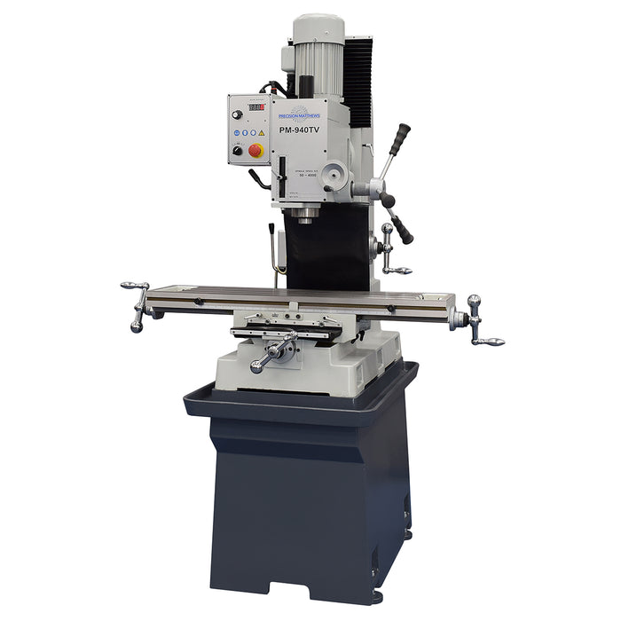

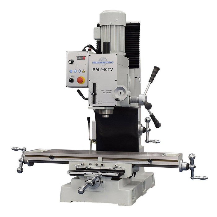

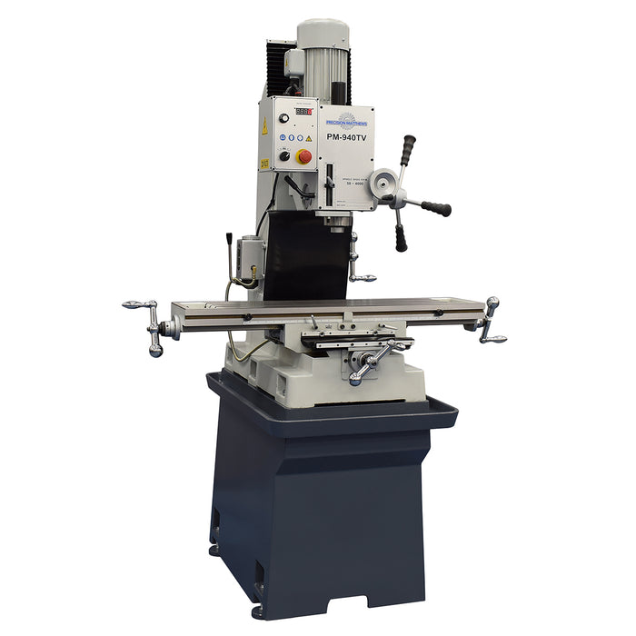

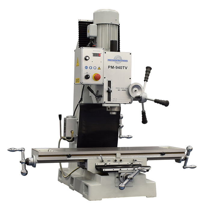

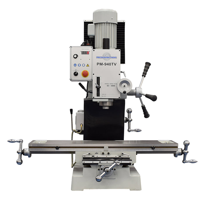

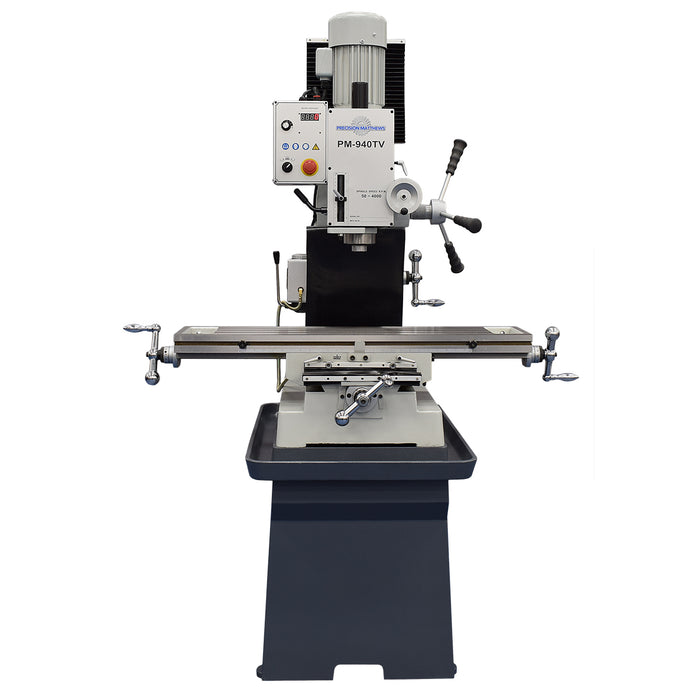

  • Very High Quality Milling Machine, 100% Made in Taiwan
  • Belt Drive, Variable Speeds, 50-4000 RPM
  • Massive Z Axis Column, and Y axis Machine Base Castings for greater rigidity throughout
  • Built For Those Users Who Are Looking For Higher Quality, Heavy Duty Mill in a Bench/Bed Mill Configuration
  • Very Large X, Y and Z Travels Compared With Other Models In This Class, over 12" Of Y axis Travel
  • One Shot Lube System Standard
  • Very High Grade FC30 Castings Used Throughout Machine
  • Industry Leading 5 YEAR WARRANTY
SKU PM-940TV
*PM-940TV - WILL UPDATE NEXT SHIPMENT ETA ONCE CURRENT STOCK SELLS OUT
Typical Users:
  • Industrial users looking for a top quality, bench/bed type milling machine, built for industrial use
  • High end gunsmiths looking for a large bench/bed type milling machine, who wish to maintain the quality and features of a Taiwan made machine
  • Users who appreciate a high end, bed/bench type milling machine
  • Any other users who can appreciate a top quality machine with full features and no shortcuts, at a very reasonable price for the level of quality that you are purchasing
PM-940TV Main Features:
  • VFD Driven VARIABLE SPEED BELT DRIVE, 50-4000 RPM
  • Extended travels provide a very large work envelope
  • Massive Z Axis Column / Y Axis Machine Base - for increased rigidity throughout
  • Made from High Grade FC-30 Cast Iron
  • Hardened table and X Axis ways for durability
  • Head Swivels 90 degrees Left and Right for angled milling / drilling operations
  • Precision Ground and Hand Scraped way Surfaces for better oil retention and fit, which leads to smoother, accurate movements
  • One Shot Lubrication system is standard equipment, which also extends machine life, and reduces oiling times
  • High precision Inch Pitch lead screws, for ease of use and greater accuracy (10 TPI Screws)
  • High Precision Spindle with +/- .0002” or less runout for greater tool life and accuracy
  • The Quill is Precision Ground, for higher accuracy
  • Easy operation, simply turn a knob up and down while you are running to change speeds
  • Tolerance Test check, each machine is checked for accuracy through a careful inspection process before shipment, the customer can always be sure they will receive a top quality machine that exceeds their expectations
  • Longest in class 5 YEAR WARRANTY against defective parts, including electrical
