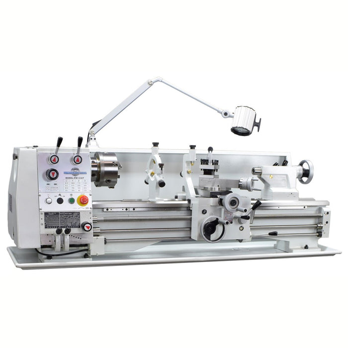

  • Extremely High Quality Lathe, meant for very high precision work. Perfect for the user who is looking for a high quality lathe, at a lower cost - Great for the serious hobbiest, gunsmith, or lighter industrial user (For heavier daily use, please select PM-1340GT)
  • 100% Made in Taiwan
  • Single Phase power available, no converters needed, or choose 3 phase if you prefer 3 phase operation
  • High Precision Japanese spindle bearings, +/- .0001" Spindle Runout
  • Leadscrews Are True Inch Pitch Screws (Not Metric Conversions Like Many), a proper 8 TPI main leadscrew, cross and compound screws are 10 Threads Per Inch (.100” Per Turn)
SKU PM-1236T-1PH
Lead times for NEW orders as of 4/4/25:
*PM-1236T-1PH - WILL UPDATE NEXT SHIPMENT ETA ONCE CURRENT STOCK SELLS OUT
*PM-1236T-3PH - WILL UPDATE NEXT SHIPMENT ETA ONCE CURRENT STOCK SELLS OUT
PM-1236T Main Features
  • Priced right, with cost saving measures to keep the price down
  • Meant for hobby-type or light industrial users who are not using the machine for heavy production, but still want the benefits of a high quality machine at a lower price point (Typical examples where the PM-1236T is suitable: high end hobby users, R&D shops, or industrial users who may use it a few days per week. If it will be used daily, please select PM-1340GT, gears and shafts in the 1340GT are different, they are a hardened alloy steel, meant for daily use, pro gunsmiths, industrial shops, production, etc.)
  • Large 1-9/16” Spindle Bore clear through spindle for through-headstock work
  • Short Spindle Length, only 13-3/4", perfect for hobby gunsmithing work
  • Extra thick spindle wall for extra rigidity, almost double when compared with most other machines in this size
  • Induction Hardened and Precision Ground Bed Ways to resist wear and give a longer service life
  • Inch AND Metric thread cutting ability is a standard feature, NO CHANGE GEARS for any inch thread or feed rate, only change gears required are for Metric threads
  • 4” Travel Thread Dial, 32 tooth gear on thread dial, 8 TPI Main Leadscrew for easier threading using the half nut / thread dial
  • Large diameter, extra thick wall tail stock quill for more rigid and accurate tail stock operations
  • Locking Tang in tail stock
  • Removable Gap for larger diameter work when needed
  • High quality electronics used throughout machine, very reliable contactors, motors, etc.
  • Slip Clutch is standard on feed rod, to help prevent overloading damage of feeds and allow the use of a solid carriage stop for repetitive work
  • Precision Tapered Roller Bearings used in spindle, for the ultimate in long life, high precision, and best surface finishes. Guaranteed Run Out +/- .0001" for ultimate precision
  • True INCH PITCH main lead screw, cross feed, and compound lead screws make it easy to use for the INCH measurement System, yet still has the Metric readings on dials for the ultimate in versatility for any job that may come about – No Confusing Metric Conversions like with some other brands
  • Splash oil bath lubrication in Headstock, and Apron, for efficient lubrication, and long life, yet simple and reliable, and does not require any filter changes or pump maintenance as with oil pump lubrication systems. Also no risk of losing oil flow to expensive parts as there can be with pump lubricated systems
  • Only Extremely High Precision Spindle Bearings are used, NACHI (Japan)
  • 3 Year Warranty covers all parts of the machine (parts only, service not included in any warranty)
PM-1236T Standard Equipment
  • PM‐1236T High Precision Lathe
  • High Precision Japanese Spindle Bearings, +/‐ .0001” Spindle Runout Max
  • 6” Economy 3 Jaw Chuck, with one Set each Inside and Outside Jaws
  • LED work Light
  • 10” Face Plate
  • Back Splash Guard
  • Chip Tray
  • 4 Way Tool Post
  • T Slotted Compound Slide (To allow easy quick change tool post installation)
  • Threading Dial (4” Travel Dial, 32 Tooth)
  • Reducing Sleeve for headstock
  • Dead Center for Headstock
  • Dead Center for Tailstock
  • Feed Rod Clutch
  • Misc. Tools for operation
  • D1‐4 Camlock Quick Change Spindle

Feed Rod Diameter 0.75"
Bed Height
11.5"
Bed Length
59.75 in
7.5 in
36"
Internal MT5
MT3
1.5625"
45 in
Spindle Length
13.75 in
17.25 in
Swing over gap
18 in
Main Leadscrew Diameter 0.875"
1.5625"
D1-4 Camlock
3.5 in
6.75 in
12
1.5
Gear Linkage
Stepped
90
1,800
Spindle Speeds
90, 135, 205, 205, 308, 475, 335, 505, 770, 780, 1160, 1800
0.002-0.02 IPR
0.001-0.01 IPR
Choice of 40, 4-112 TPI
Choice of 24, 0.25-7.5mm pitch
65.5 in
22 in
48.5 in
850 lb
72 in
32 in
36 in
900 lb
29 in
66 in
51 in
Shipping weight is approx. 1000 pounds, and ships fully crated on a 72"x32" skid. Stand adds 16" to height.
Click Here for Manual (Manual is for 1340GT, all operations are the same with this model): PM-1236T 1340GT v10 2022-08
Supplemental feed rate chart, shows the exact feed rates for each lever position with 40T change gears both top and bottom: PM 1236T And 1340GT Thread Chart
