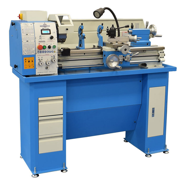

PM-1130V 11"x30" Precision Lathe
Original price $4,299.00 - Original price $4,899.00
$4,299.00
$4,299.00 - $4,899.00
Current price $4,299.00
  • D1-4 Camlock Spindle Mount Now Standard
  • Large 1-1/2" Spindle Bore
  • AXA Wedge Type Quick Change Tool Post set included, installed, ready for use
  • Variable Spindle Speeds by reliable AC Inverter (VFD) Drive
  • Super Smooth and Quiet Running Machine
  • Lead screws Are True Inch Pitch Screws (Not Metric Conversions Like Many), 10 Threads Per Inch (.100” Per Turn) on Cross Slide, Compound Slide, and Tailstock for easy Inch measurement readings
  • Backed by an industry leading 3 year warranty
$249 Flat Rate Shipping in the 48 US States – Any accessories ordered with machine at the same time also ship free of charge! (Will automatically calculate at checkout)
SKU PM-1130V-w/PKG

PM-1130V Main Features
  • Made in an ISO 9002 Certified Factory
  • High Quality Electronics Used Throughout Machine for long term reliability

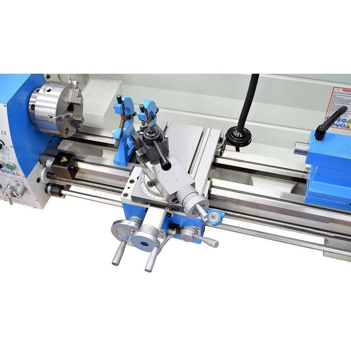

  • POWER CROSS FEED, BOTH IN, OUT, and LEFT and RIGHT, and WILL CUT
  • LEFT HAND THREADS TOO
  • Super Smooth and Quiet running machine
  • Heavy Duty Bed Width 7" (same width as most 12"x36" Machines)
  • Variable Speed 120 Volt Single Phase Input Power, 1.5HP Main Motor, AC Inverter Drive
  • Variable Spindle Speeds From 75-2000 rpm (2 Ranges, Low 75-500 RPM for more torque, and High 300-2000 RPM for more speed)
  • Inch Threads and Metric Threading, Both Right and Left Hand Threading
  • Spindle is Dynamically Balanced, Hardened and Precision Ground
  • Spindle is Supported by High Precision, Class 5, Adjustable Tapered Roller Bearings
  • All Gears and Shafts are Hardened and Precision Ground
  • Guideways Induction Hardened and Precision Ground for long life
  • REAL INCH LEADSCREW AND FEED SCREWS for even, easy measurements, No Metric Conversions like with many others out there

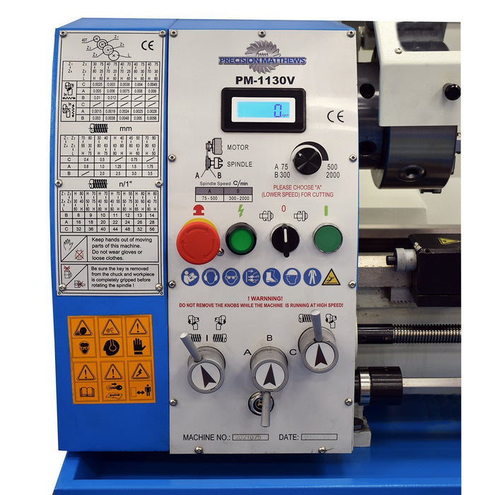

  • Digital Speed Readout Tachometer on face of machine
  • 3 Year Warranty - Best in the industry!
PM-1130V Standard Accessories
  • 6" 3 Jaw Chuck, Scroll Type, D1-4 Mount w/Inside and Outside jaws
  • Wedge Type Quick Change Tool Post, with 5 Holders (AXA/100 size)
  • Face Plate, D1-4 Mount

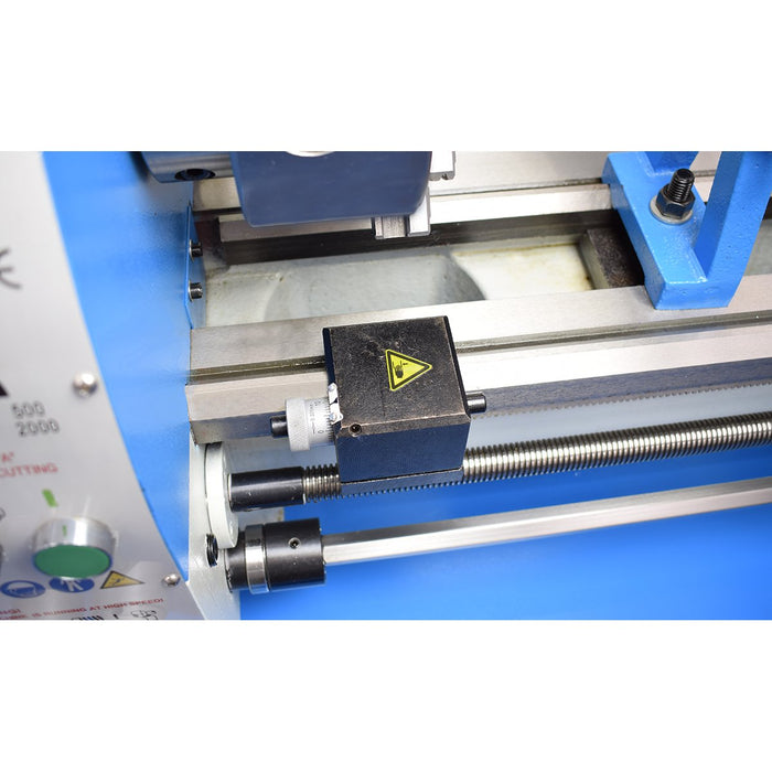

  • Micro Carriage Stop
  • Inch and Metric Threading
  • Thread Chasing Dial
  • Headstock Dead Center
  • Tailstock Dead Center
  • Misc. Tools for operation (Wrenches, etc)
  • Variable Spindle Speeds, 1.5HP Motor
  • Power Cross Feed, In, Out, Left, and Right Feed
  • Left Hand thread cutting with the flip of a lever

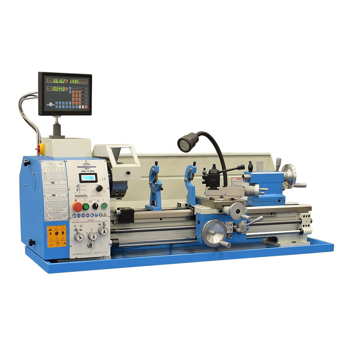

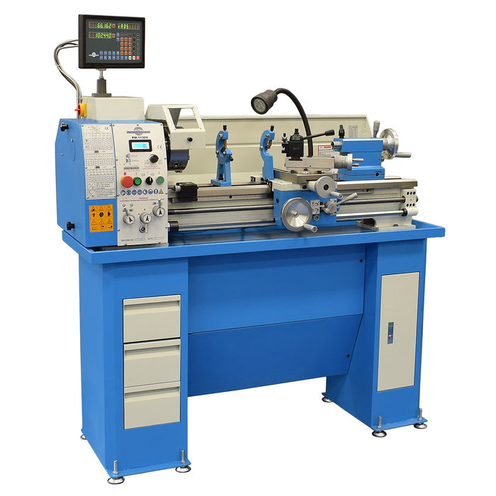

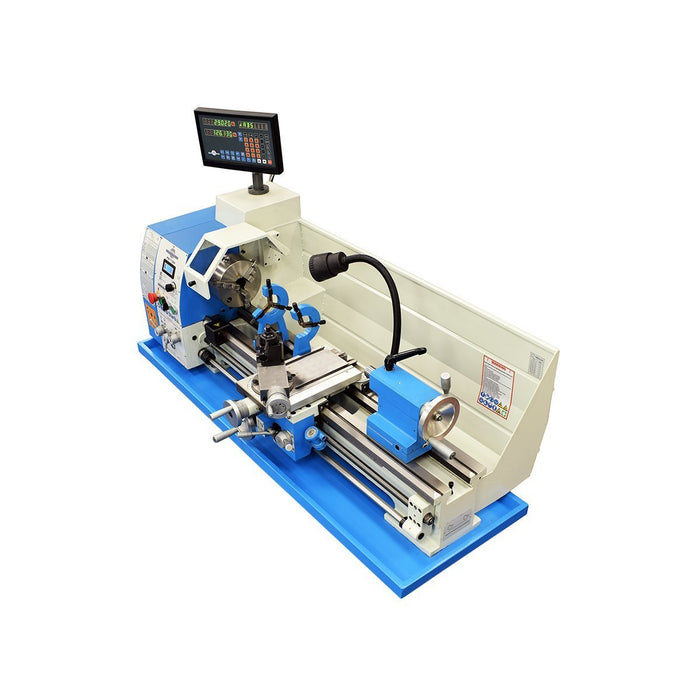

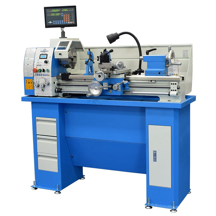

OPTIONAL DRO model shown below (This is included only if the model with DRO Installed is selected):

Click Here for Optional DRO Manual: PM Lathe DRO Manual 7-30-2019 V.1
Click Here for Optional DRO Setup: Setting Up Precision Matthews Lathe DRO
If the machine will not start, be sure that the belt cover is on, and the safety switch on the cover is properly engaged
