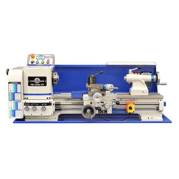

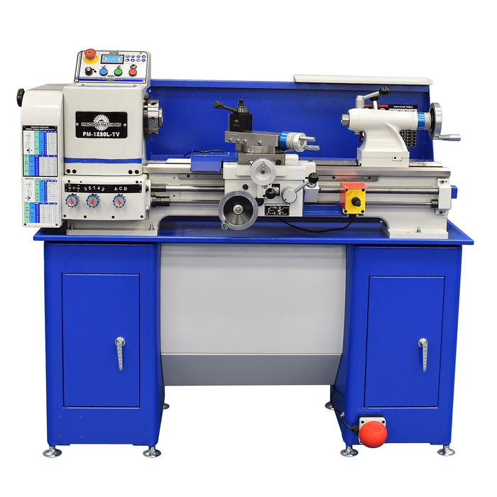

  • NEW! Our very popular Taiwanese Lathes in the smallest platform yet!
  • Extremely High Quality Lathe, meant for very high precision work, suitable for light to medium use by Professionals or Hobbyists
  • Excellent machine for Gunsmithing use, Very Short Spindle, Ultra High Precision
  • Pre-Wired plug for a standard 110V Outlet, powering a 2 HP motor
  • Variable Speed control from 50-2,000 RPM
SKU KT-PM-1230L-TV
**PM-1230L-TV** - WILL UPDATE NEXT SHIPMENT ETA ONCE CURRENT STOCK SELLS OUT
PM-1230L-TV Main Features
  • High Quality Lathe, Made in TAIWAN
  • Quality NTN Brand Spindle bearings
  • Large 1.5” Spindle Bore clear through spindle for through-headstock work
  • Short Spindle Length, only 17-3/4"
  • Inch AND Metric thread cutting ability is a standard feature, NO CHANGE GEARS for any inch thread or feed rate, only change gears required are for Metric threads
  • 4” Travel Thread Dial, 32 tooth gear on thread dial, 8 TPI Main Leadscrew for easier threading using the half nut / thread dial
  • Large diameter, thick wall tail stock quill for more rigid and accurate tail stock operations
  • Slip Clutch is standard on feed rod, to help prevent overloading damage of feeds and allow the use of a solid carriage stop for repetitive work
  • True INCH PITCH main lead screw, cross feed, and compound lead screws make it easy to use for the INCH measurement System
  • Longest in class, 5 Year Warranty
PM-1230L-TV Standard Accessories
  • Back Splash Guard
  • Economy Spindle Spider
  • Back Splash Tool Holder
  • AXA Size Quick Change Tool Post w/ Five (5) Tool Holders and Precision Matthews Manufactured T-Nut
  • Threading Dial (4” Travel Dial, 32 Tooth)
  • Feed Rod Clutch
  • Foot Brake/Off Button
  • Chip Tray
  • D1‐4 Camlock Quick Change Spindle
  • Belt Cover Interlock Switch
*Note, chucks are not included standard, please select chuck option from the optional accessories if you need a chuck with your machine
