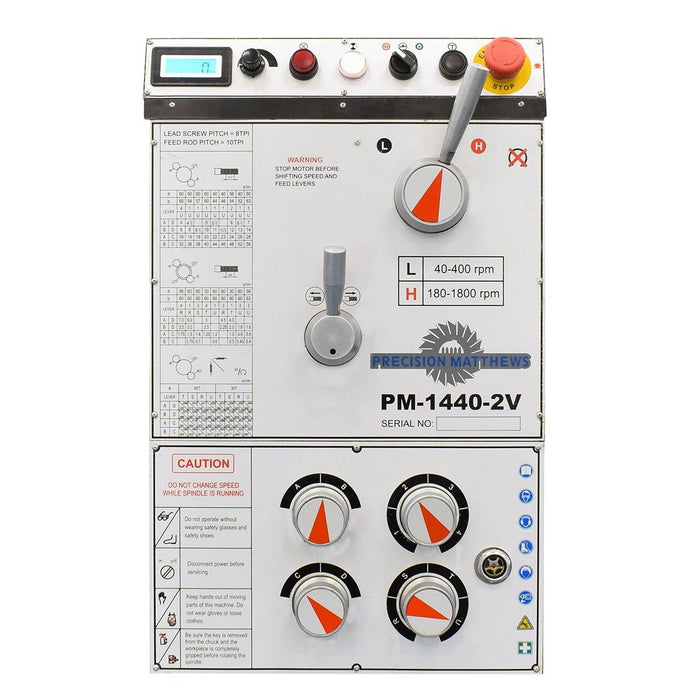

  • Variable Spindle Speeds, from 40-1800 RPM
