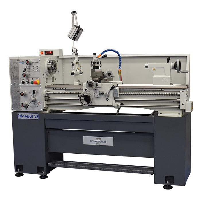

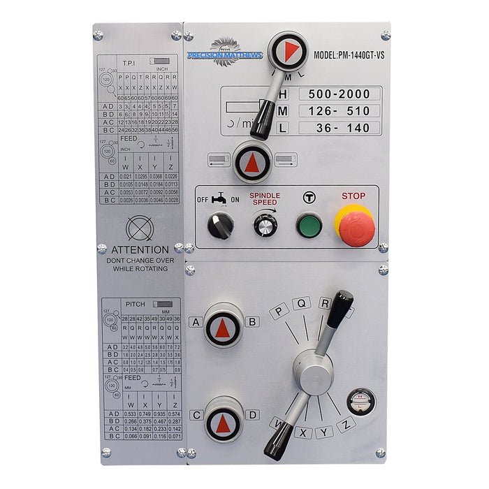

  • NEW! Variable Spindle Speeds, driven by a Hitachi VFD Adjust spindle speed on the fly, which allows for the best possible surface finishes. (Low 36-140RPM, Med 126-510RPM, High 500-2000RPM)

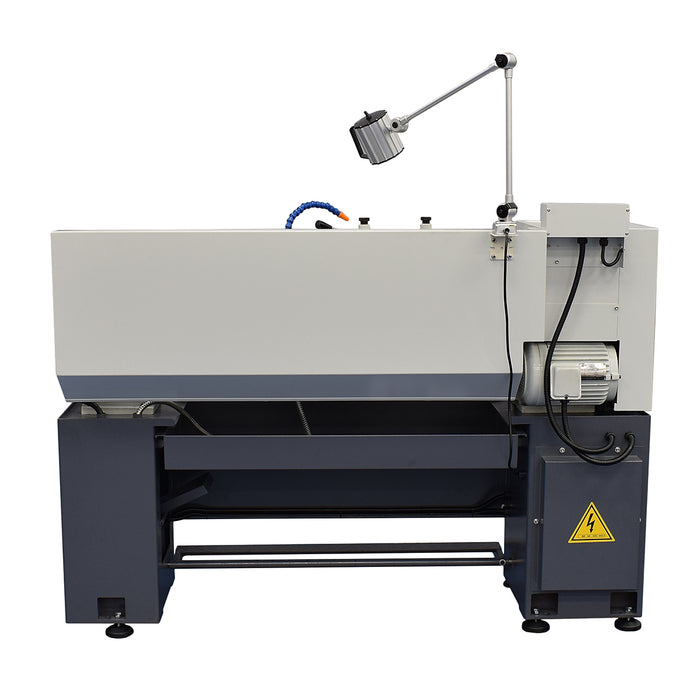

  • Machine can run on Single OR 3 Phase Power - No expensive phase converters needed if you only have standard 240V single phase available, it comes ready to operate on either
  • Photos shown are of PM-1440GT Model - The new PM-1440GT-VS Looks identical except for a different spindle speed range on the headstock. Photos to be updated shortly
  • Extremely High Quality Lathe, meant for very high precision work, and suitable for every day use. Perfect for the professional user who is looking for the best available
  • This model operates on either Single or 3 Phase power due to the Variable Frequency Drive - No expensive phase converters needed
  • Priced very, very reasonably when compared with other similar high quality models - and no one out there has the 2" Spindle bore in a machine from Taiwan. Compare Carefully. No one out there even comes close
  • Excellent machine for Gunsmithing use, Very Short Spindle, Ultra High Precision
  • High Precision, Hardened and Ground gears throughout headstock, which leads to extremely smooth and quiet running for a geared head lathe
SKU KT-PM-1440GT-VS
Lead times for NEW orders as of 10/8/26:
-If showing Available On Backorder, the next available shipment ETA is listed below:
**PM-1440GT-VS** - ETA LATE JAN 2027
PM-1440GT-VS Main Features
  • This PM-1440GT-VS is a brand new model as of 2025. This is the same as our popular PM-1440GT Lathe, but now with Variable Spindle Speeds, driven by a Hitachi Variable Frequency Drive, with 3 speed ranges. This allows you to dial in your speeds during operation, allowing for the best possible surface finishes.
  • Machine operates on both Single or Three Phase - No need for expensive converters if you only have single phase available
  • Large 2” Spindle Bore clear through spindle for through-headstock work
  • Short Spindle Length, only 15-1/2", perfect for gunsmithing work
  • All gears and shafts in headstock hardened and precision ground for long life and extremely quiet running
  • FC-25 Meehanite Cast Iron used for rigidity and vibration dampening
  • Removable Gap for larger diameter work
  • Slip Clutch on feed rod, to help prevent overloading damage of feeds and allow the use of a solid micrometer carriage stop for repetitive work
  • High Precision Tapered Roller Bearings used in spindle, for the ultimate in long life, high precision, and best surface finishes. Guaranteed Run Out +/- .0001" for ultimate precision
  • Inch AND Metric thread cutting ability is a standard feature
  • Splash oil bath lubrication in Headstock, and Apron, for efficient lubrication, and long life, yet simple and reliable, maintenance as with oil pump lubrication systems. Also no risk of losing oil flow to expensive parts as there can be with pump lubricated systems
  • Only Extremely High Precision Japanese Spindle Bearings are used, NACHI Brand at this time
  • Locking Tang in tail stock
  • Longest in the industry, 5 Year Warranty!
PM-1440GT-VS Standard Accessories
(Machine operates on both single or 3 phase)
  • Variable Spindle Speeds driven by a Hitachi VFD- Adjustable on the fly while running
  • Complete Base with Chip Tray
  • L.E.D. Work Light
  • NACHI (Japan) Spindle bearings, with +/- .0001" Max Spindle Runout
  • D1-5 Quick Change Spindle Mount
  • Back Splash Guard
  • Reducing Sleeve for Headstock Center
  • 4 Way Tool Post
  • Headstock Dead Center
  • Tail Stock Dead Center
  • Thread Chasing Dial (4” Travel Thread Dial, for easier inch thread cutting)
  • Feed Rod Clutch (To prevent overloading and using carriage stops)
  • Everything Needed for listed Inch and Metric Thread Pitches
  • Coolant System
  • Foot Brake
  • Belt Cover Interlock Switch
  • D1-5 Face Plate (12" Diameter)
  • (6) Pcs Cast Iron Leveling Pads with Bolts
*Note, chucks are not included standard, please select chuck option from the optional accessories if you need a chuck with your machine
