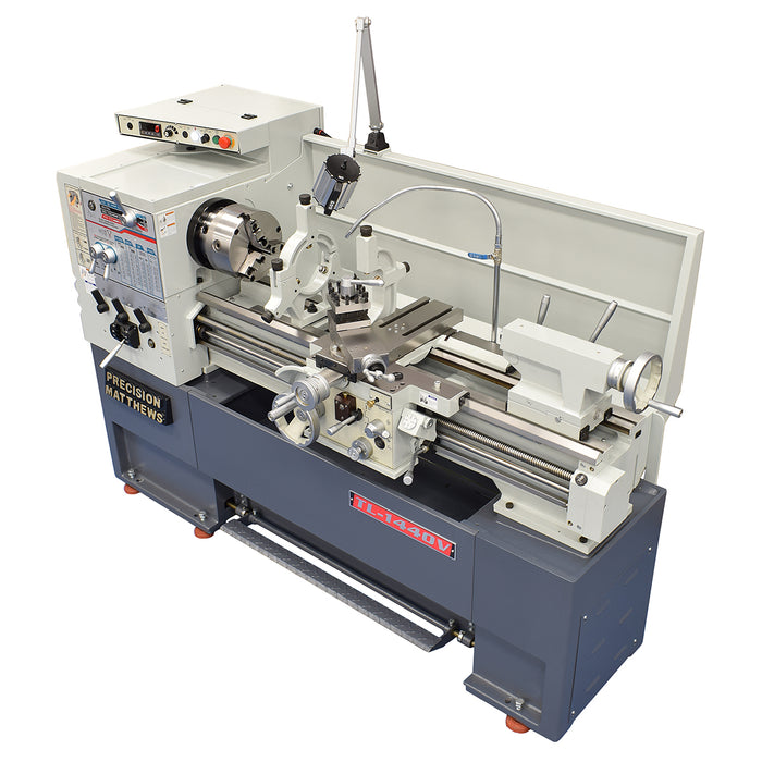

  • Extremely High Quality Lathe, meant for very high precision work, and suitable for every day use. Perfect for the professional user who is looking for the best available machine
  • Uses 208-240V Single OR 3 Phase Power without modification - No converters needed for single phase operation
  • Variable Spindle Speeds from 30-2500 RPM, in 3 ranges
  • Very heavy duty machine, almost 2 tons of iron in these models
  • Priced very, very reasonably when compared with other similar high quality models - and no one out there has the 2.55" Spindle bore. Compare Carefully
  • Excellent machine for industrial shop use, built for daily, all-day use
  • High Precision, Hardened and Ground gears throughout headstock lead to extremely smooth and quiet running for a geared head lathe and very long life

PM-1440TL-V / PM-1640TL-V / PM-1660TL-V Main Features
  • Highest Quality Lathes, Made in TAIWAN
  • Large 2-1/2" Spindle Bore clear through spindle for through-headstock work (Actual dimension 2.55", will pass a 2-1/2" bar)

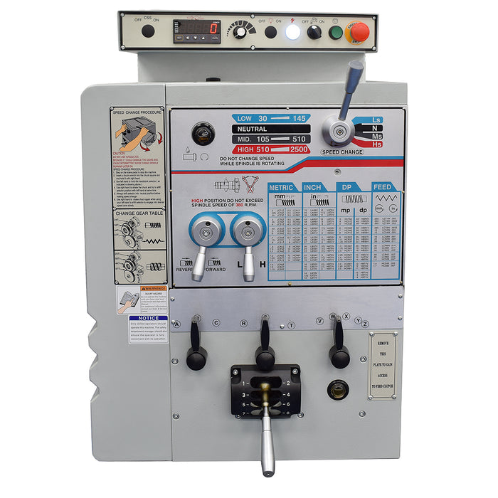

  • Variable Spindle Speeds from 30-2500 RPM, in 3 ranges (Low 30-145, Medium 105-5110, High 510-2500 RPM)
  • No change gears needed for the entire range of Inch and Metric thread pitches
  • Inch AND Metric thread cutting ability is a standard feature
  • Power feed on Carriage and Cross Slide, both left and right, and in-and-out, for both turning and facing operations with automatic feed. Allows for the best surface finish in all directions.
  • Turcite B coating on carriage for extremely smooth operation and long life
  • All gears and shafts in headstock hardened and precision ground for long life, and precision ground for extremely quiet running
  • Meehanite Cast Iron used for rigidity and vibration dampening
  • Wide 10-1/4" bed provides more stability in heavier work
  • Removable Gap for larger diameter work
  • Slip Clutch on feed rod, to help prevent overloading damage of feeds and allow the use of a solid micrometer carriage stop for repetitive work
  • High Precision Tapered Roller Bearings used in spindle, for the ultimate in long life, high precision, and best surface finishes. Guaranteed Run Out +/- .0001" for ultimate precision
  • One shot lubrication pump on carriage for easier lubrication and longer life
  • Only Extremely High Precision Japanese Spindle Bearings are used
  • Locking Tang in tail stock
  • Longest in the industry, 5 Year Warranty!

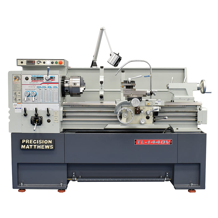

PM-1440TL/PM-1640TL/PM-1660TL Standard Accessories
  • High Precision 9” 3 Jaw Chuck, with Bolt On Jaws (can also use soft jaws)
  • D1-6 Camlock Spindle
  • 2.55” (65mm) Spindle Bore
  • L.E.D. Work Light
  • Leveling Pads
  • Complete Cast Iron Base with slide out Chip Tray
  • High Precision (Japan) Spindle bearings, with +/- .0001" Max Spindle Runout
  • Back Splash Guard
  • Reducing Sleeve for Headstock Center
  • 4 Way Tool Post
  • Headstock Dead Center
  • Tail Stock Dead Center
  • Thread Chasing Dial
  • Feed Rod Clutch (To prevent overloading and using carriage stops)
  • Everything Needed for listed Inch and Metric Thread Pitches
  • Coolant System
  • Foot Brake

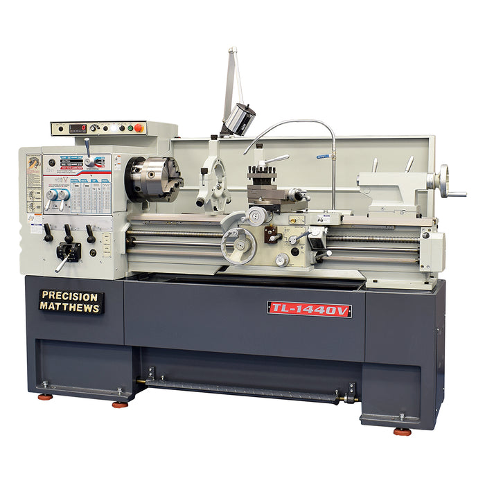

Additional Specifications
  • Compound (top slide) width (Where tool post sits, for tool post sizing) 3.937" (100mm)
  • Leveling bolt thread/size: M16x2.0, 70mm long
10.25 in
40" , 60"
Gap Insert Length
Internal MT4
MT4
2.55"
47 in
44" , 64"
Spindle Length
24 in
Main (Threading) Leadscrew Pitch 4 TPI
2.047" (52mm)
D1-6 Camlock
Lathe swing over bed
14" , 16"
Swing Over Cross-slide
8" , 10"
Swing Over Gap
21" , 23"
Variant Base
Cast Iron Base
4.94 in
8.75 in
30
Dual 1Φ or 3Φ
5
Dual Stepped and Variable
30
2,500
0.002-0.067 IPR
0.001 -0.034 IPR
Choice of 45, from 2-72 TPI
Choice of 39, from 0.2-14 mm pitch
Diametral Pitch
Worm Gear
Choice of 21, 8-44 DP
Module Pitch
Worm Gear
Choice of 18, 0.3-3.5 MP
90 in , 110 in
41 in , 42 in , 44 in
72 in , 74 in
3600 lb , 4000 lb , 4500 lb
90 in , 110 in
72 in , 74 in
SC-F55E , SC-B60E
No
36 in
109 in
