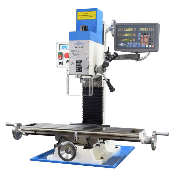

PM-30MV Main Features
Special Features that set this mill apart from others (BE SURE TO COMPARE THESE DIFFERENCES):
  • MUCH Larger Travels and work area
  • Quill DRO Included Standard (This is for the spindle up/down movement)
  • 3 Bolt Head Mount is now standard (where the head mounts to the Z Axis), for more rigidity when milling - Much improved over the single bolt mount type
  • Main Z Axis Column is attached to the base with 4 bolts, and mounted from the top, with a wide, proper mounting surface for much more rigidity over other models in this size range
  • 0.001" Readings with larger dials on the X and Y axis, with true 10 Thread Per Inch Leadscrews make it easier to cut accurately - (One line on the dial is 0.001", one full turn of the handwheel is 0.100", much easier to use than those with odd metric conversions)
  • 50-3000 RPM variable speed with the turn of a knob, properly set up with Low and High for a wider speed range, and plenty of power at lower speeds
  • Precision ground ways for smoother movements - Not just rough milled
  • Thrust Bearings in leadscrew ends - not bushings - Much smoother movements and less backlash
  • Split nuts on X and Y Axis to allow for backlash adjustment
  • DC BRUSHLESS MOTOR, Variable Speed, POWERFUL, SMOOTH, and RELIABLE Belt Drive from Motor to Spindle runs MUCH quieter than others, and eliminates any failure prone plastic gears (And the hassle of changing them when stripped)
  • 3 Year Warranty, for added peace of mind

  • Stand
  • 3 Axis DRO Installed Note: if a 3 axis DRO is added to the machine, the 3rd axis of the DRO reads the HEAD up and down, Not the quill, so it is not doubling up on the measurement. If you add the 3 axis DRO, now both Z Axis movements are covered)
