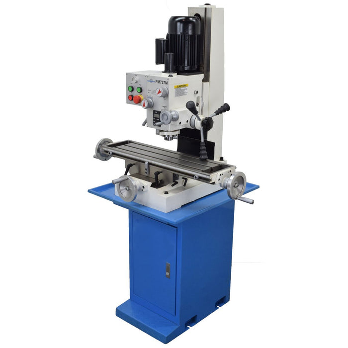

  • All Hardened and Ground Steel Gears in head, for much heavier cutting capability, particularly when compared with plastic gear equipped models
  • Compact Size for smaller work shops, but has more weight and power to remove material when needed
  • Table Graduations in .001" on X and Y with a true Inch Pitch Leadscrew, leads to easier operation when tolerances matter
  • Main Column is attached to the base with 4 bolts from the top, with a very wide mounting surface for much more rigidity over other models in this size range
  • Only Requires Standard 120V Single Phase Circuit, so it can be set up virtually anywhere, without needing additional circuits installed in your work shop
  • 3 Year Warranty, for added peace of mind

  • Compact, Accurate, Economical Machine. Great for those who are looking for a compact machine for a smaller work shop, yet need the ability to take heavier cuts compared with other machines in this size range
  • Spindle is Supported by High Precision Tapered Roller Bearings
  • Mill Head May be Tilted ±90° (both left and right)
  • Precision Manual Fine Down Feed is standard
  • Adjustable Tapered Gibs for longer life
  • Positive Locks are standard for Table, Head, Quill, and Column
  • Easy Reading Dials Have Satin Chrome Finish, Graduated in 0.001"
  • Quill DRO is Standard, Accuracy of the Display 0.0005”, Selectable from mm/inch
  • Generous 18-1/4" Spindle To Table Max Distance for taller work
  • 8-1/2" Y Axis Travel, More than other machines in this class
