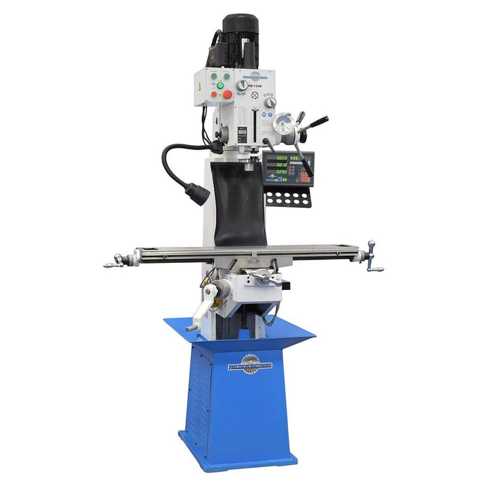

  • High Grade HT200 Castings
  • Design is exclusive to us. You will not find another machine that stacks up in features, and price
  • Same head as used on our bench mills, but now available as a knee mill
  • Long 5" Quill Travel
  • Tramming Ability in X AND Y Directions: Head Swivels Left and Right, AND Tilts Front To Back (approx +/-10 degrees) to set spindle to table tram, only machine in this size class with this feature - Allows tramming in all directions - Perfect alignment for the high precision jobs - Very critical, great feature for extremely high precision work!
  • Generous 19-1/2" spindle to table distance
  • COMPARE EVERYTHING WITH OTHER MILLS ON THE MARKET - NONE EVEN COME CLOSE
  • Inch Pitch lead screws, for ease of use and greater accuracy (10TPI Screws, .100" per turn)
  • Precision Spindle with +/- .00025” or less runout for greater tool life and accuracy
  • Longest in class 3 YEAR WARRANTY against defective parts, including electrical

Model PM-739M
Precision Geared Head Vertical Knee Type Milling Machine (Geared head, machine has 6 spindle speeds which are chosen by selector knobs on the head)
Typical Users:
  • Industrial users looking for a good quality, smaller vertical knee type milling machine, built for lighter R&D / repair shop type use, with a smaller size to save space, at a lower price point
  • High end gunsmiths looking for a smaller knee type milling machine, who wish to maintain the quality and features of a full sized knee mill, but also want to save on space / cost
  • Users who appreciate the operational differences when going to a knee type milling machine over a bench style mill
  • Any other users who can appreciate an entry level knee mill at a very reasonable price
PM-739M Main Features:
  • Design is exclusive to us. You will not find another machine that stacks up in features and price
  • Inch Pitch lead screws, for ease of use and greater accuracy (10TPI Screws, 0.100" per turn)
  • Precision Spindle with +/- 0.00025” or less runout for greater tool life and accuracy
