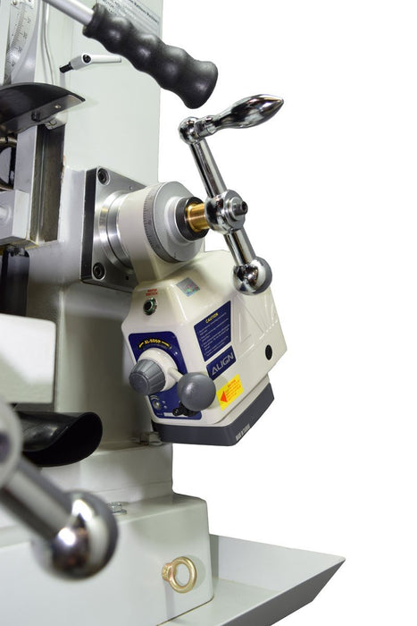

X Axis Power Feed installation instructions can be found here:  X Power Feed Installation, PM-833T  With a note here:  PM 833T X Feed Gear Note
