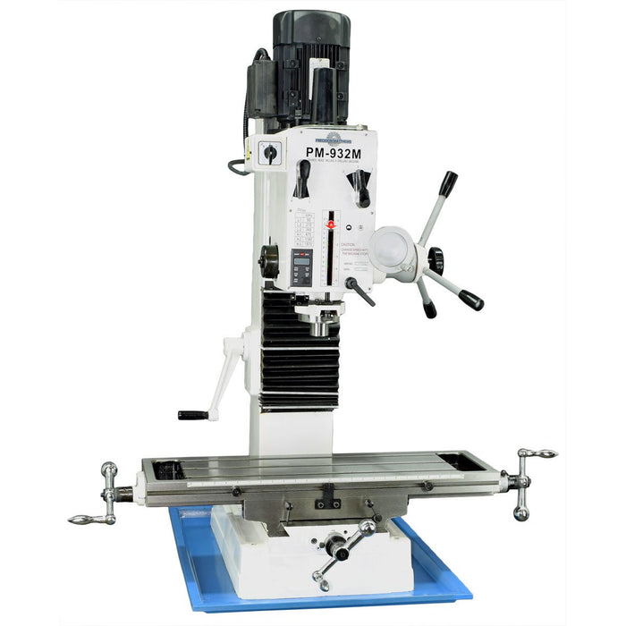

  • Heavier Class Milling Machine, (1100 LBS With Base) For More Rigidity, And Greater Cutting Ability
  • Larger Knee Mill Style Table Handles, for Much Better Control By Hand
  • True Inch Pitch Leadscrews on X and Y Axis, 10 TPI Screws (.100" Per Turn) For Easier Operation
  • Available With Power Down Feed on Spindle (PDF Model Only) For Boring Operations
  • Optional Stand is Heavy Duty Cast Iron, For Better Vibration Dampening and Rigidity
  • Longest In Class, 3 Year Warranty

PM-932M Machine Options
ALL Machines now come with larger mill style crank handles for better feel and easier operation by hand, as shown in main picture
1. PM-932M-BASIC
Includes: Quill DRO, Manual Down Feed on spindle
2. PM-932M
Includes: Quill DRO, Z Axis (Head) Positioning Motor, X Axis Table Feed, Manual Down Feed on spindle
3. PM-932M-w/3axDRO
Includes: Quill DRO, Z Axis (Head) Positioning Motor, X Axis Table Feed, Manual Down Feed on spindle PLUS, 3 axis Precision Matthews DRO Installed (3rd axis is on Head up/down movement, not a duplicate of quill travel)
4. PM-932M-PDF
Includes: Quill DRO, Z Axis (Head) Positioning Motor, X AxisTable Feed, Power Down Feed on spindle for drilling and boring
5. PM-932M-PDF-w/3axDRO
Includes: Quill DRO, Z Axis (Head) Positioning Motor, X Axis Table Feed, Power Down Feed on spindle for drilling and boring, PLUS 3 axis Precision Matthews DRO, Installed (3rd axis is on Head up/down movement)
STAND IS OPTIONAL FOR ALL MODELS
*If no base is desired, a Sheet Metal Coolant/Chip Tray is also available as an option, if you would still like a chip pan with your machine. This will not work with the cast iron base, because the cast iron base option already has a ship/coolant tray built in.
