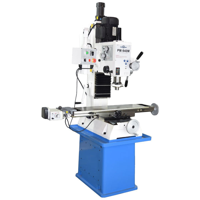

  • Heavier Class Milling Machine, (1350 LBS With Base) For More Rigidity, And Greater Cutting Ability, yet ships in 2 pieces (Base separately) so it is easier to handle
  • Larger Knee Mill Style Table Handles, for Much Better Control By Hand
  • Huge 12" Y axis travel, matched with a 26" X axis travel and generous 20" Z travel allows room for those larger jobs. This machine has a larger work envelope than many full sized knee mills.
  • Real Inch Pitch Leadscrews on X and Y Axis, 10 TPI Screws (.100" Per Turn) For Easier Operation - Not a close metric conversion like with many others
  • Available With Power Down Feed on Spindle (PDF Model Only) For Boring Operations
  • Base is Heavy Duty Cast Iron, For Excellent Vibration Dampening
  • Longest In Class, 3 Year Warranty

#1 PM-940M-BASIC
Includes: Quill DRO, Cast Iron Base, Manual Down Feed on spindle - This model is for those who want a basic machine, and do not need the X and Z feed motors
#2 PM-940M-BASICw/HRDWYS
Same as #1, but with the hardened way option - Great for someone who will convert to CNC, who would remove the X and Z Feed Motors anyway, so it is sold without these. This version has the hardened ways, which greatly extended life, especially when converted to CNC
#3 PM-940M
Includes: Quill DRO (For spindle depth measurement), Z Axis (Head) Positioning Motor (used to lift and lower head for positioning, eliminates the need to raise and lower head by hand cranking) X Axis Table Feed, Manual Down Feed on spindle, and Cast Iron Base
#4 PM-940M w/3axDRO
Same as #3, but with 3 axis Precision Matthews DRO Installed (Installed on Table X and Y Travels, plus Z axis head up/down travel
Note: the quill DRO, which is standard, is for the spindle travel, so this DRO does not duplicate that. The 3 axis reads the full head travel)
#5 PM-940M-PDF
Includes: Quill DRO (For spindle depth measurement), Z Axis (Head) Positioning Motor (used to lift and lower head for positioning, eliminates the need to raise and lower head by hand cranking) X Axis Table Feed, POWER DOWN FEED on spindle, and Cast Iron Base
(Note: Same as #3, with the addition of Power Down Feed on spindle for boring operations)
#6 PM-940M-PDF w/3axDRO
Same as #5, but with 3 axis Precision Matthews DRO Installed (Installed on Table X and Y Travels, plus Z axis head up/down travel
#7 PM-940M-PDF w/HRDWYS
Same as #5, but with Hardened Ways on X and Y Axis for better wear resistance - longer life in heavier use situations or over time
#8 PM-940M-PDF w/HRDWYS&3axDRO
Same as #6 with the 3 axis DRO Installed, and also #7 with with Hardened Ways on X and Y Axis for better wear resistance - longer life in heavier use situations or over time - So this model has all options, Power Down Feed on spindle, 3 axis DRO Installed, X Axis Power Feed, and Hardened Ways
