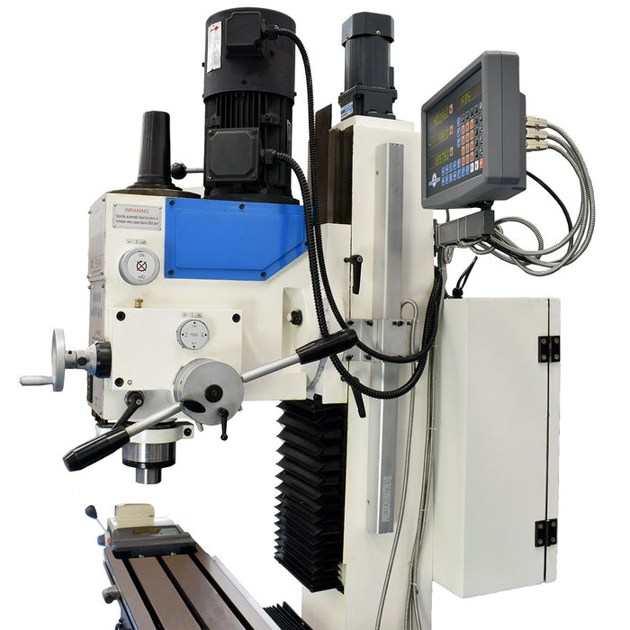

  • Variable Speeds to 5000 RPM for better performance in softer materials such as aluminum or brass, High RPM desirable for CNC conversions
  • Heavier class Milling Machine, (1350 LBS With Base) for more rigidity and greater cutting ability, yet ships in 2 pieces (Base separately) so it is easier to handle
  • Larger Knee Mill-style table handles, for much better control by hand
  • Huge 12" Y axis travel, matched with a 26" X axis travel and generous 20" Z travel allows room for those larger jobs. This machine has a larger work envelope than many full sized knee mills.
  • Real Inch Pitch Leadscrews on X and Y Axis, 10 TPI Screws (.100" Per Turn) for easier operation - Not a close metric conversion like with many others
  • Available with Power Down Feed on Spindle (PDF model only) for Boring Operations
  • Base is Heavy Duty Cast Iron, for excellent vibration dampening

* ALL Models below now come with knee mill style crank handles for better feel and easier operation by hand, as shown in main picture

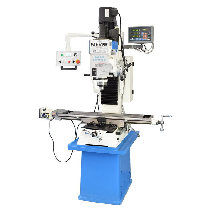

#1 PM-940V-BASIC
Includes: Quill DRO, Cast Iron Base, Manual Down Feed on spindle - This model is for those who want a basic machine, and do not need the X and Z feed motors
#2 PM-940V-BASIC-w/HARDWAYS
Same as #1, but with the hardened way option - Great for someone who will convert to CNC, who would remove the X and Z Feed Motors anyway, so it is sold without these. This version has the hardened ways, which greatly extended life, especially when converted to CNC
#3 PM-940V-PDF-w/HARDWAYS
With Power Down Feed on Spindle/Quill for Boring, also with Hardened Ways on X and Y Axis for better wear resistance - longer life in heavier use situations or over time. This model also includes an X Axis (Table) Power Feed.
#4 PM-940V-PDF-w/HARDWAYS-w/3axDRO
Same as #3 with the addition of 3 axis DRO Installed, So this model has all options, Power Down Feed on spindle, 3 axis DRO Installed, X Axis Power Feed, and Hardened Ways.
