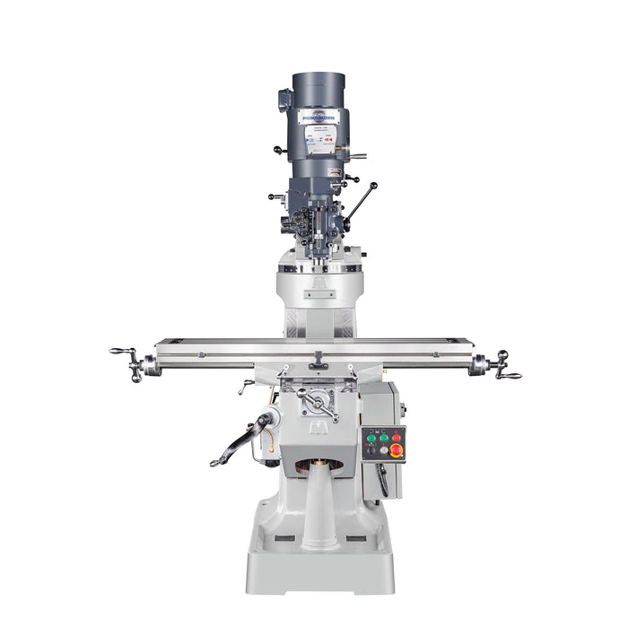

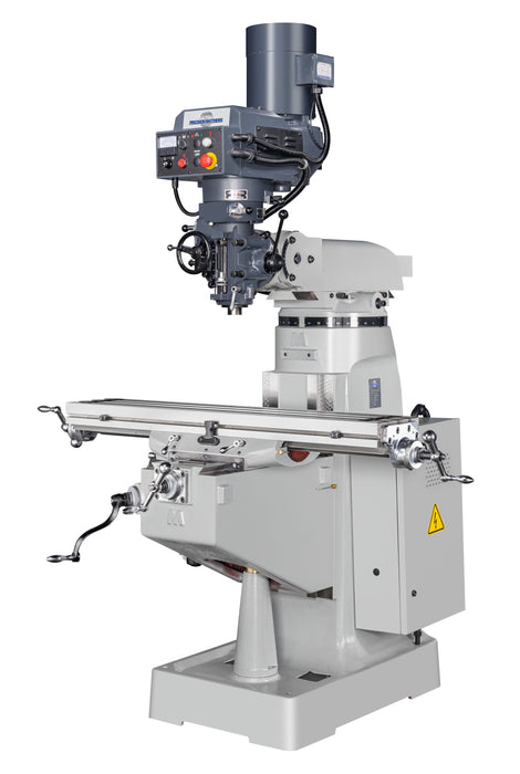

  • Ultra High Quality Milling Machine, 100% Made in Taiwan. Top Of The Line Machine Without Question
  • Patented 6 T-Bolt Knuckle Design - Provides a slight advantage in clamping of the knuckle, particularly when moved often (The knuckle is the part which allows the head to tilt forward and back. This model uses 6 T-bolts over the traditional 3-through bolt design)
  • UL/CSA (NRTL) Approved Electrical for all models in this series
  • Built For Those Users Who Do Not Want To Sacrifice Quality
  • Full Featured Head, With Power Feed On Quill For Boring Operations, Etc.
  • Turcite B Way Coating, Provides Very Smooth Movements In Table, and Longer Life
  • High Grade Meehanite Castings Used Throughout Machine
  • Industry Leading 5 YEAR WARRANTY

Main High Quality Features:
  • 6 T Bolt lock design on knuckle compared to the traditional 3 through bolt design. (This 6 bolt design is patented. This design provides slightly better clamping at the knuckle. Particularly useful for those who tilt the head forward and back often)
  • UL/CSA (NRTL) Listed Electrical Components (Main motor, wiring, switches, VFD on EVS Model)
  • PM-949T-6S is a 3 Phase, Step Pulley Machine
  • PM-949T-6V-1PH is a Single Phase, Traditional Variable Speed Belt Drive Machine
  • PM-949T-6V-3PH is a Three Phase, Traditional Variable Speed Belt Drive Machine
  • PM-949T-6EVS is a Single or Three Phase (Same machine uses either power source) Variable Speed, EVS (Electronic Variable Speed) via Hitachi Variable Frequency Drive Machine
  • Head Swivels Left and Right, AND Tilts Front To Back
  • Turcite B way material for smoother table movements
  • Hardened and Ground table and way surfaces greatly reduces wear, which maintains accuracy, and greatly extends machine life
  • One Shot Lubrication system is standard equipment, which also extends machine life, and reduces oiling times of all way surfaces and lead screws to seconds, it is accomplished by simply pumping a lever
  • High precision Inch Pitch lead screws, for ease of use and greater accuracy (5TPI Screws)
  • High Precision Spindle with +/- .0001” or less runout for greater tool life and accuracy
  • Balanced pulleys in head for smooth and quiet operation
  • Full featured head with automatic quill feeds in 3 steps for boring operations
  • The Quill is Precision Ground, then Hard Chrome Plated for longer life
  • Available with either step pulley speed changes, or variable speeds to suit the user's preferences
  • Built in coolant sump in machine base
  • Tolerance Test Certificate included, each machine is checked for accuracy through a careful inspection process before shipment, the customer can always be sure they will receive a top quality machine that exceeds their expectations
  • Longest in class 5 YEAR WARRANTY against defective parts, including electrical (excludes normal wear items such as belts, bushings, etc)
