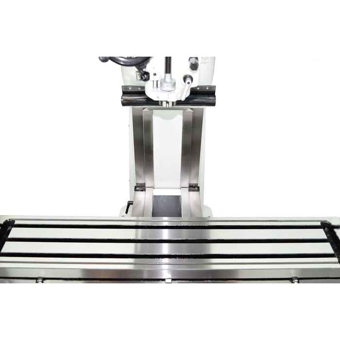

  • Turcite B Way Coating, Provides Very Smooth Movements In Table, and Longer Life

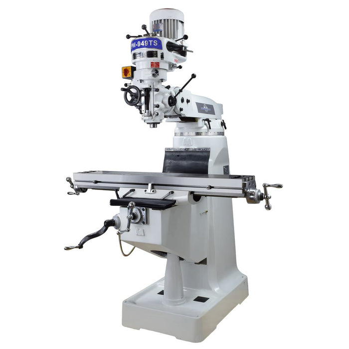

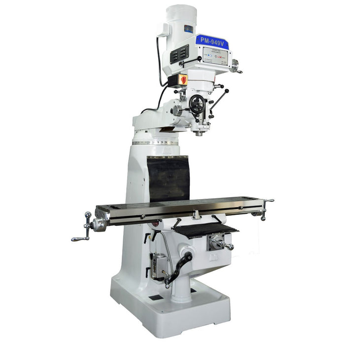

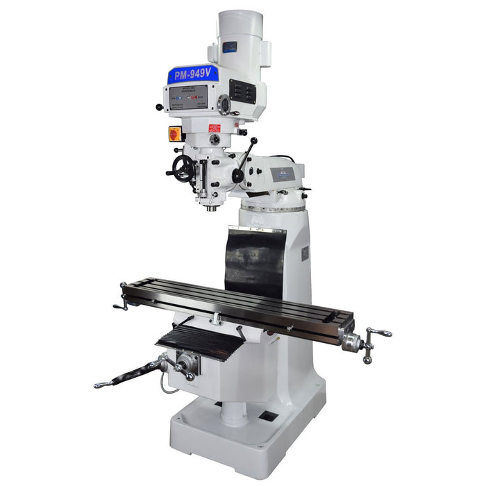

Model PM-949TS and PM-949TV High Precision Vertical Knee Type Milling Machines
Typical Users:
  • Industrial users looking for a top quality, full featured vertical knee type milling machine, built for industrial use
  • High end gunsmiths looking for the quality and features of a full sized, high quality knee mill
  • Users who appreciate a high end, full featured knee type milling machine with the space saving characteristics this offers, built for every day, professional use
  • Any other users who can appreciate a top quality machine with full features and no shortcuts, at a very reasonable price for the level of quality that you are purchasing
Main High Quality Features:
  • High Grade Meehanite Castings

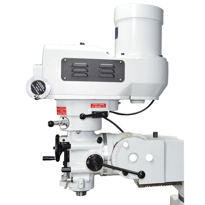

  • Head Swivels Left and Right, AND Tilts Front To Back
  • Turcite B way material for smoother table movements
  • Hardened and Ground table and way surfaces greatly reduces wear, which maintains accuracy, and greatly extends machine life
  • One Shot Lubrication system is standard equipment, which also extends machine life, and reduces oiling times of all way surfaces and lead screws to seconds, it is accomplished by simply pumping a lever
  • High precision Inch Pitch lead screws, for ease of use and greater accuracy (5TPI Screws)
  • High Precision Spindle with +/- .0001” or less runout for greater tool life and accuracy

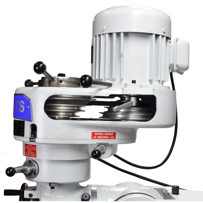

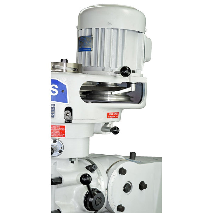

  • Balanced pulleys in head for smooth and quiet operation
  • Full featured head with automatic quill feeds in 3 steps for boring operations
  • The Quill is Precision Ground, then Hard Chrome Plated for longer life
  • Available with either step pulley speed changes, or variable speeds to suit the user's preferences
  • Built in coolant sump in machine base
  • Tolerance Test Certificate included, each machine is checked for accuracy through a careful inspection process before shipment, the customer can always be sure they will receive a top quality machine that exceeds their expectations
  • Longest in class 5 YEAR WARRANTY against defective parts, including electrical (excludes normal wear items such as belts, bushings, etc)
