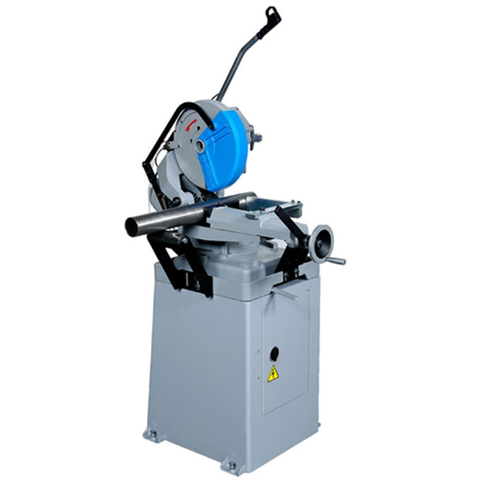

  • Operates on 220V Single Phase Power
  • VARIABLE BLADE SPEEDS for the best cutting speed to match the job from 24-120 RPM
  • Quick Acting lever for angle changes, can be done in only a few seconds
  • This saw has a 90 degree swivel head, for slotting capability
  • Quick Acting vise lever, for faster operation on multiple cuts of the same size
  • Miters 45 degrees, both ways (Left and Right)
  • Adjustable Work Stop with Inch/MM Readings included as standard equipment, for faster repetitive cuts
  • Coolant System is standard equipment

CS-350 Main Features:
  • Heavy Duty Cast Iron Body for chatter free cutting
  • 5 Year Warranty!
CS-350 Standard Equipment: *Special, includes (1) 350mm General Purpose Blade (12-11-2020)
  • 220V Single Phase Operation
  • (1) Pc 350mm General Purpose Blade
  • Variable Speed 24-120 RPM
  • Stand/Base
  • Work Stop with Inch/MM Graduations
  • Blade Guard
  • Quick Acting Vise Handle
  • Coolant System
  • Operator's Manual and Parts List
Additional Specifications:
  • Coolant System
Saw Type Cold Saws
Arbor Size
Diameter of hole for mounting blade to machine
32mm
Blade Diameter
Diameter of saw blade
14", 350mm
Blade Speed 24-120 RPM
Saw Head Miter Max Angle
Maximum Miter angle
45° Left / 45° Right (with 90° turn for slotting operations)
Round Solid at 90°
Max cutting capacity for this shape and angle.
3.5"
Rectangle Tubing at 90°
3.5"x6.28125"
Square Tubing at 90°
4"x4"
Round Pipe at 90°
4.75"
Round Solid at 45°
3"
Rectangle Tubing at 45°
3.3125"x3.5"
Square Tubing at 45°
3.5"
Round Pipe at 45°
4"
