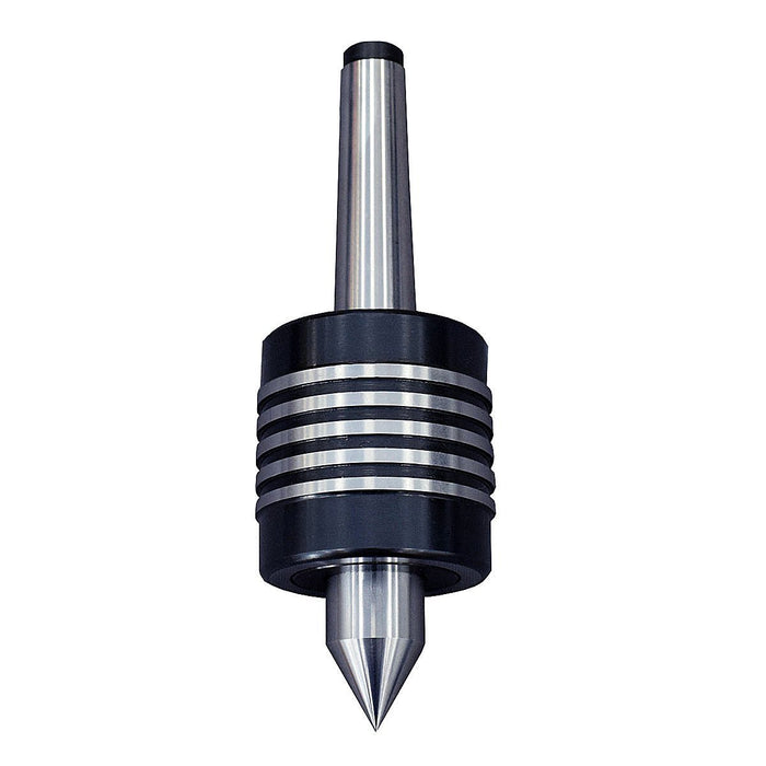

  • Exceptionally HIGH QUALITY, built to last and perform
  • Made from High Quality Steel – 1040 (For Body) and A295 Alloy Steel (For Quill/ Point Center) – NOT just Plain 1018 steel like many others
  • Body is Surface Hardened then precision ground, 60 Degree point is oil hardened through to 56-60 HRC for long life
  • Heavy Duty Bearing Support, One #6203 Ball Bearing, plus one #30203 Tapered Roller bearing in the front to handle any load
  • Ultra High Precision, Maximum of +/-.0002″ Runout!
  • MT-3 Morse Taper Shank to fit many of the most popular lathes
  • One Piece Integrated Shank, no tapers to come apart or move
SKU LC-MT3-HD
Heavy Duty High Precision Live Center, Main Features:
  • Made from High Quality Steel - 1040 (For Body) and A295 Alloy Steel (For Quill/ Point Center)
  • Ultra High Precision, Maximum of +/-.0002" Runout!
  • Max RPM 5000 will handle almost any job
  • Close fit, sealed from chips, debris, oil, etc.
