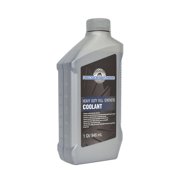

Precision Matthews Premium Heavy Duty Synthetic Universal Coolant / Cutting Fluid can be used in Lathes, Mills, Grinders, Saws, and more. Dilute coolant 5% to 8% (Approx. 6 to 10 OZ of coolant mix per gallon of water) coolant to water with Distilled or Deionized water if available. Tap water works fine also but may reduce coolant life and corrosion protection.

Precision Matthews Heavy Duty Full Synthetic Coolant is a premium quality, water-soluble, oil free, heavy duty synthetic coolant developed for grinding, drilling, cutting, milling, sawing, forming, tapping/threading, knurling, reaming, boring, turning, broaching, shaping/slotting, blanking, stamping of Aluminum Alloys, Titanium/Tungsten & Nickel Alloys, Super Alloys & Stainless Steels, Chromium Alloys, Molybdenum, Carbon & Tool Steels, Cast Irons, Copper Alloys, Powdered Metals, Brass & Bronze, Refractory Metals, Plastics & Composites, Glass and other ceramic materials to provide unique extreme pressure lubrication and excellent part finishes in modern CNC and Manual machining operations. It is specially designed with a special corrosion protection package and a biocide package to provide outstanding system protection and minimize the friction and heat between the tools and parts.
Precision Matthews Heavy Duty Full Synthetic Coolant is recommended for use in CNC and manual Machining, Gun Drilling, Gang Drills, Lathes, Turning Centers, Tube and
Pipe Mills, Sawing & Cut-off, Creep Feed Grinding, Central Systems, Machining Centers, FMS, Roll Forming, Mills, High Speed & High Pressure Machining.
Precision Matthews Heavy Duty Full Synthetic Coolant should be diluted with deionized (DI) or Distilled water (If Available) to a concentration of 5% to 8% (volume%) depending on the machining operation and type of material. Tap water can be used, but may reduce coolant life and corrosion protection.
Note: Always premix coolant before adding to the machine sump. Never add
straight water or straight concentrate coolant directly to the machine sump. If
mixing by hand, always add concentrate coolant to water, and then agitate.
Coolant concentration may be monitored with a refractometer
Technical Specifications:
  • Appearance Blue
  • PH (Concentrate) 9.4
  • Specific Gravity 1.05
  • Boiling Point (100C, 212F)
  • Pour Point (-18C, 0F)
