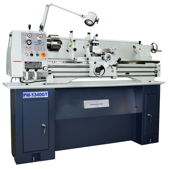

  • Extremely High Quality Lathe, meant for very high precision work, and suitable for every day use. Perfect for the professional user who is looking for the best available
  • Excellent machine for Gunsmithing use, Very Short Spindle, Ultra High Precision
  • Available in either Single or 3 Phase power, to match the user's needs
  • High Precision, Hardened and Ground gears throughout headstock, which leads to extremely smooth and quiet running for a geared head lathe, and much longer life (Suitable for daily, professional use)
SKU KT-PM-1340GT-1PH
Lead times for NEW orders as of 7/16/26:
**PM-1340GT-1PH** - WILL UPDATE NEXT SHIPMENT ETA ONCE CURRENT STOCK SELLS OUT
**PM-1340GT-3PH** - WILL UPDATE NEXT SHIPMENT ETA ONCE CURRENT STOCK SELLS OUT

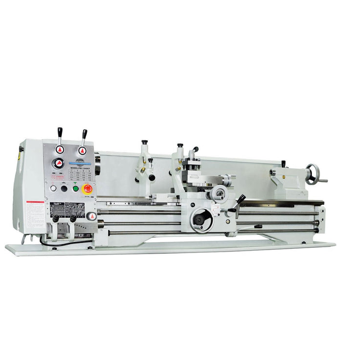

PM-1340GT Main Features
  • Large 1-9/16” Spindle Bore clear through spindle for through-headstock work
  • Short Spindle Length, only 13-3/4", perfect for gunsmithing work
  • Extra thick spindle wall for extra rigidity, almost double when compared with most other machines in this size
  • All shafts in headstock hardened and ground along with gears which are precision ground, set in with a close tolerance fit, which leads to longer life and quiet running when compared with other geared head lathes
  • Inch AND Metric thread cutting ability is a standard feature, NO CHANGE GEARS for any inch thread or feed rate, only change gears required are for Metric threads
  • 4” Travel Thread Dial, 32 tooth gear on thread dial, 8 TPI Main Leadscrew for easier threading using the half nut / thread dial
  • Large diameter, extra thick wall tail stock quill for more rigid and accurate tail stock operations
  • Locking Tang in tail stock
  • Removable Gap for larger diameter work when needed
  • High quality electronics used throughout machine, very reliable contactors, motors, etc.
  • Slip Clutch is standard on feed rod, to help prevent overloading damage of feeds and allow the use of a solid carriage stop for repetitive work
  • Precision Tapered Roller Bearings used in spindle, for the ultimate in long life, high precision, and best surface finishes. Guaranteed Run Out +/- .0001" for ultimate precision
  • Splash oil bath lubrication in Headstock and Apron, for efficient lubrication and long life, yet simple and reliable, and does not require any filter changes or pump maintenance as with oil pump lubrication systems. Also, no risk of losing oil flow to expensive parts as there can be with pump lubricated systems
  • Only Extremely High Precision Spindle Bearings are used, NACHI (Japan)
  • Longest in class, 5 Year Warranty
PM-1340GT Standard Accessories
(Machine is available in either single or 3 phase, select from drop down when ordering)
  • Back Splash Guard
  • L.E.D. Work Light
  • High Precision NSK Spindle Bearings, +/‐ .0001” Spindle Runout Max
  • 4 Way Tool Post
  • Threading Dial (4” Travel Dial, 32 Tooth)
  • Reducing Sleeve for headstock
  • Dead Center for Headstock
  • Dead Center for Tailstock
  • Feed Rod Clutch
  • Chip Tray
  • Misc. Tools for operation
  • D1‐4 Camlock Quick Change Spindle
  • Belt Cover Interlock Switch
  • D1-4 Face Plate (10")
*Note, chucks are not included standard, please select chuck option from the optional accessories if you need a chuck with your machine
Feed Rod Diameter 0.75"
Bed Height
11.5"
Bed Length
63.75 in
7.5 in
40"
Follow Rest Capacity
Maximum diameter of workpiece supported by follower rest, in inches.
1.5 in
Gap Insert Length
7.75 in
Internal MT5
MT3
1.5625"
46 in
Spindle Face to Gap End
Maximum distance between face of spindle to the far end of lathe bed gap insert, in inches
5.5 in
Spindle Length
13.75 in
17.25 in
Steady Rest Capacity
Maximum diameter of workpiece that can be supported by steady (center) rest, in inches.
6.5 in
Swing over gap
19.13 in
Main Leadscrew Diameter 0.875"
1.5625"
D1-4 Camlock
3.5 in
6.75 in
1PH , 3PH
2
Gear Linkage
Stepped
90
1,800
Spindle Speeds
90, 135, 205, 205, 308, 475, 335, 505, 770, 780, 1160, 1800
0.002-0.02 IPR
0.001-0.01 IPR
Choice of 40, 4-112 TPI
Choice of 24, 0.25-7.5mm pitch
69.25 in
1100 lb
72 in
32 in
36 in
960 lb
69.25 in
22 in
48.5 in
Shipping Crate Size: 30"W x 30" H x 72" L
Shipping weight is approx. 1100 pounds, and ships fully crated on a 72"x32" skid. Stand adds 16" to height.
