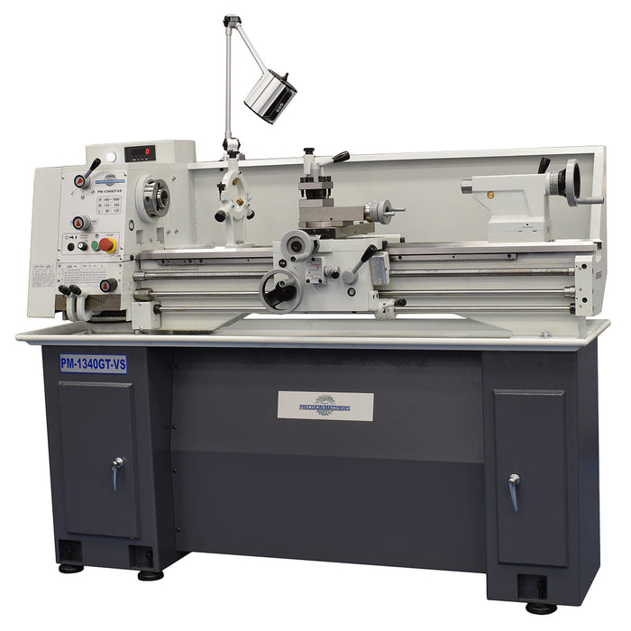

  • NEW! Our very popular PM-1340GT with Variable Speed control!
  • Extremely High Quality Lathe, meant for very high precision work, and suitable for every day use. Perfect for the professional user who is looking for the best available
  • Excellent machine for Gunsmithing use, Very Short Spindle, Ultra High Precision
  • Can be wired in either single phase or 3 phase
  • High Precision, Hardened and Ground gears throughout headstock, which leads to extremely smooth and quiet running for a geared head lathe, and much longer life (Suitable for daily, professional use)
SKU KT-PM-1340GT-VS
**PM-1340GT-VS** - WILL UPDATE NEXT SHIPMENT ETA ONCE CURRENT STOCK SELLS OUT
PM-1340GT-VS Main Features

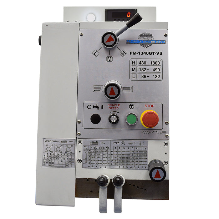

  • Variable Speed control powered by a Schneider Electric ATV320 VFD
  • Large 1-9/16” Spindle Bore clear through spindle for through-headstock work
  • Short Spindle Length, only 15-1/4", perfect for gunsmithing work
  • Extra thick spindle wall for extra rigidity, almost double when compared with most other machines in this size
  • All shafts in headstock hardened and ground along with gears which are precision ground, set in with a close tolerance fit, which leads to longer life and quiet running when compared with other geared head lathes

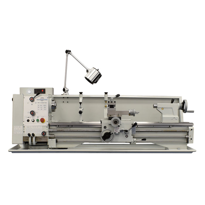

  • Inch AND Metric thread cutting ability is a standard feature, NO CHANGE GEARS for any inch thread or feed rate, only change gears required are for Metric threads
  • 4” Travel Thread Dial, 32 tooth gear on thread dial, 8 TPI Main Leadscrew for easier threading using the half nut / thread dial
  • Large diameter, extra thick wall tail stock quill for more rigid and accurate tail stock operations
  • Locking Tang in tail stock
  • Removable Gap for larger diameter work when needed
  • High quality electronics used throughout machine, very reliable contactors, motors, Schneider Electric VFD, etc.
  • Slip Clutch is standard on feed rod, to help prevent overloading damage of feeds and allow the use of a solid carriage stop for repetitive work
  • Precision Tapered Roller Bearings used in spindle, for the ultimate in long life, high precision, and best surface finishes. Guaranteed Run Out +/- .0001" for ultimate precision
  • Splash oil bath lubrication in Headstock and Apron, for efficient lubrication and long life, yet simple and reliable, and does not require any filter changes or pump maintenance as with oil pump lubrication systems. Also, no risk of losing oil flow to expensive parts as there can be with pump lubricated systems
  • Only Extremely High Precision Spindle Bearings are used, NACHI (Japan)
  • Longest in class, 5 Year Warranty

  • D1‐4 Camlock Quick Change Spindle
  • Belt Cover Interlock Switch
  • D1-4 Face Plate (10")

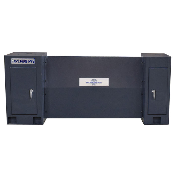

Shipping weight is approx. 1100 pounds, and ships fully crated on a 72"x32" skid. Stand adds 16" to height.
