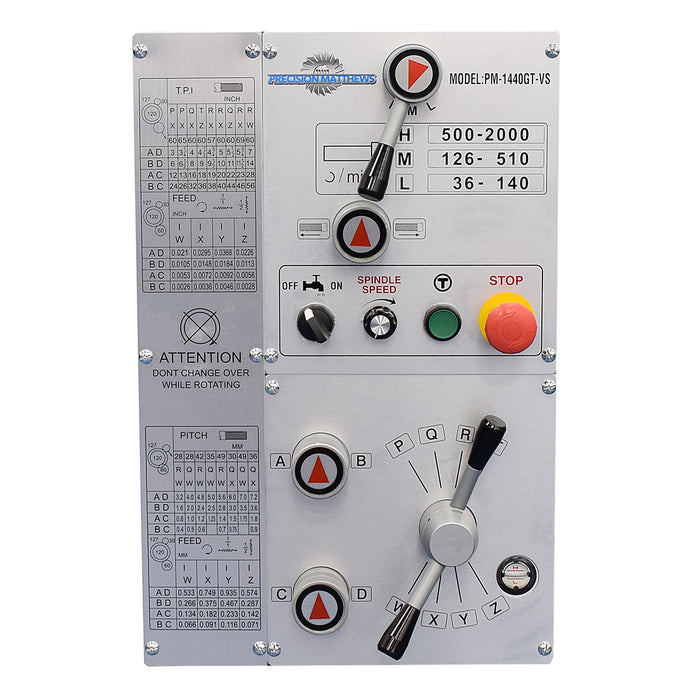

  • NEW! Variable Spindle Speeds, driven by a Hitachi VFD Adjust spindle speed on the fly, which allows for the best possible surface finishes. (Low 36-140RPM, Med 126-510RPM, High 500-2000RPM)

50, 70, 95, 140, 180, 250, 340, 510, 700, 980, 1350, 2000
0.0026-0.0368 IPR
0.0013-0.0184 IPR
Choice of 36, 3-56 TPI
Choice of 34, 0.4-7.2mm pitch
