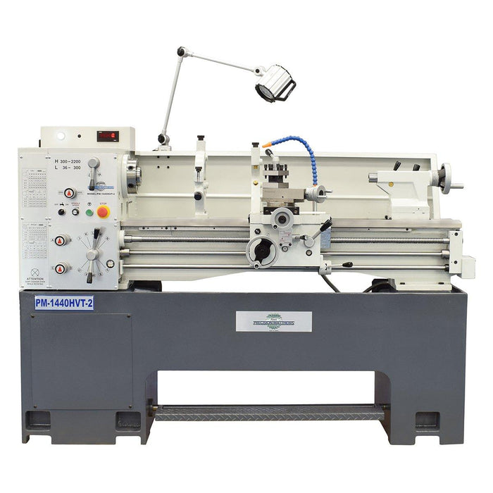

  • Variable Speeds, VFD Driven, 30-2200 RPM
  • Operates on Single OR 3 Phase Power with No Modification, No Phase Converters or Modifications Needed!
  • 2" Spindle Bore
  • Heavier Frame Machine with Wide 9" Bed
  • Standard with Heavy Duty Steel Base, or Available with Optional Cast Iron Base
  • Extremely High Quality Lathe, meant for very high precision work, and suitable for every day use. Perfect for the professional user who is looking for the best available
  • Priced very, very reasonably when compared with other similar high quality models - and no one out there has the 2" Spindle bore in a machine from Taiwan. Compare Carefully. No one out there even comes close
  • Excellent machine for Gunsmithing use, Heavy Duty Ultra High Precision
  • High Precision, Hardened and Ground gears throughout headstock, which leads to extremely smooth and quiet running for a geared head lathe

Highlighted Features
  • Variable Speed 30-2200 RPM - Comes Standard with Built in variable spindle speed via VFD drive
  • This machine runs on single OR 3 phase with no modification
  • Wider 9" bed
  • 2" Spindle Bore
  • Option of either a heavy duty welded steel base, or upgraded Solid Cast Iron Base (Choose from drop down menu when ordering, either Steel Base, or Cast Iron Base Model - Identical machine otherwise, some people just prefer the extra weight of a cast base for a slight increase in rigidity)
PM-1440HVT-2 Main Features
  • Large 2” Spindle Bore clear through spindle for through-headstock work
  • Variable Spindle Speeds – Adjust spindle speed while cutting to dial in for the perfect cutting conditions
  • Shorter Spindle Length, only 17-3/8″, good for gunsmithing work
  • Power feed on Carriage and Cross Slide, both left and right and in-and-out, for both turning and facing operations with automatic feed. Allows for the best surface finish in all directions.
  • All gears and shafts in headstock hardened and precision ground for long life and extremely quiet running
  • FC-25 Meehanite Cast Iron used for rigidity and vibration dampening
  • Removable Gap for larger diameter work
  • Slip Clutch on feed rod, to help prevent overloading damage of feeds and allow the use of a solid micrometer carriage stop for repetitive work
  • High Precision Tapered Roller Bearings used in spindle, for the ultimate in long life, high precision, and best surface finishes. Guaranteed Run Out +/- .0001″ for ultimate precision
  • Inch AND Metric thread cutting ability is a standard feature True INCH PITCH main lead screw, cross feed, and compound lead screws make it easy to use for the INCH measurement System, yet still has the Metric readings on dials for the ultimate in versatility for any job that may come about
  • Splash oil bath lubrication in Headstock, and Apron, for efficient lubrication, and long life, yet simple and reliable, maintenance as with oil pump lubrication systems. Also no risk of losing oil flow to expensive parts as there can be with pump lubricated systems
  • Only Extremely High Precision Japanese Spindle Bearings are used, NACHI Brand at this time
  • Locking Tang in tail stock
  • Longest in the industry, 5 Year Warranty!
