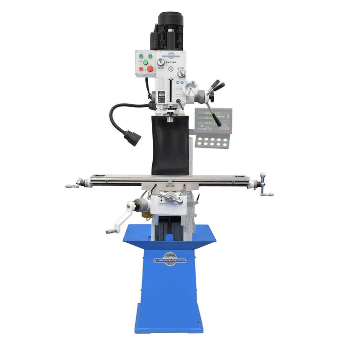

  • High Grade HT200 Castings
  • Design is exclusive to us. You will not find another machine that stacks up in features, and price
  • Same head as used on our bench mills, but now available as a knee mill
  • Long 5" Quill Travel
  • Tramming Ability in X AND Y Directions: Head Swivels Left and Right, AND Tilts Front To Back (approx +/-10 degrees) to set spindle to table tram, only machine in this size class with this feature - Allows tramming in all directions - Perfect alignment for the high precision jobs - Very critical, great feature for extremely high precision work!
  • Generous 19-1/2" spindle to table distance
  • COMPARE EVERYTHING WITH OTHER MILLS ON THE MARKET - NONE EVEN COME CLOSE
  • Inch Pitch lead screws, for ease of use and greater accuracy (10TPI Screws, .100" per turn)
  • Precision Spindle with +/- .00025” or less runout for greater tool life and accuracy
  • Longest in class 3 YEAR WARRANTY against defective parts, including electrical

Model PM-739M
Precision Geared Head Vertical Knee Type Milling Machine (Geared head, machine has 6 spindle speeds which are chosen by selector knobs on the head)

PM-739M Main Features:
  • Design is exclusive to us. You will not find another machine that stacks up in features and price
  • Inch Pitch lead screws, for ease of use and greater accuracy (10TPI Screws, 0.100" per turn)
  • Precision Spindle with +/- 0.00025” or less runout for greater tool life and accuracy
Additional Specifications
  • Y Axis Travel 8-1/2” (Shorted by 1" to 7-1/2" with X DRO Scale on rear of table)
Headstock Tilt, Front to Rear ±15°
Headstock Tilt, Left to Right ±45°
Spindle Height
53 in
19.5 in
Spindle to Table Minimum
0.00025
Spindle Bearing Class C5
Spindle Bearing Type Tapered Roller Bearings
10 TPI (0.100" per turn)
25 in
8.5 in
17.5 in
39 in
7.5 in
9/16", 14mm
Spacing between T Slots
2.0"
33.5 in
Table Height Maximum
51 in
1PH
2
Gear Linkage
Stepped
90
1,970
Spindle Speeds
90, 210, 345, 670, 1180, 1970
89 in
967 lb
74 in
967 lb
SC-F40LE
8459.59
53 in
83 in
This mill ships fully crated, crate measures 48"L x 42"W x ~74"H (Head ships rotated in the crate To Lower Overall Height)
