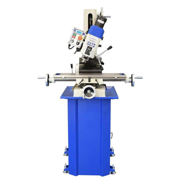

  • Ultra High Quality Milling Machine, Made to Exacting Standards. Nothing Else Compares To The Quality Level Of This Mill. If You Want The Best, This Is It. This machine is 100% Made in Taiwan. It Costs More, But You Get More. Much More. The Highest Level of Quality and Precision in a Bench Top Mill Available Anywhere.

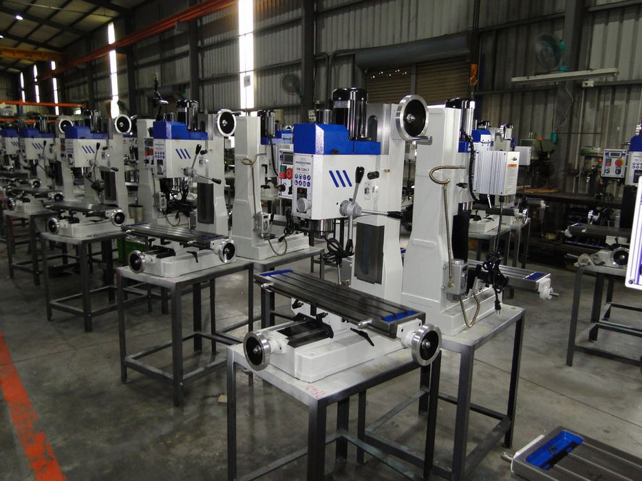

  • Super Precise Way Grinding Matched with Highly Skilled Precision Fitting and Scraping of Matching Way Surfaces and Gibs Make This Machine A Step Above Anything Else On The Market
  • Larger Travels Than Comparable Models, Especially in the Y and Z Axis
  • More Weight, Approx. 370 Pounds To Work With. Easy Enough To Move, Heavy Enough To Take Serious Cuts

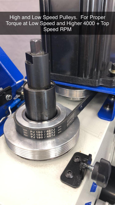

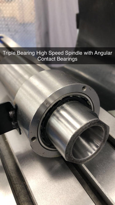

  • Ultra Precision Ground Spindle, with Triple Bearing Support
  • Spindle is Supported by Angular Contact Bearings, Which Run Precise and Stay Cool at High Speeds

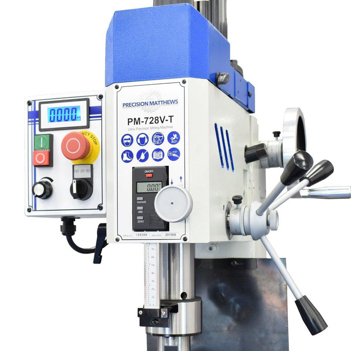

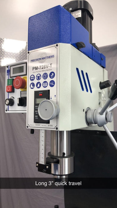

  • Quill DRO Included Standard (This is for the spindle up/down movement)

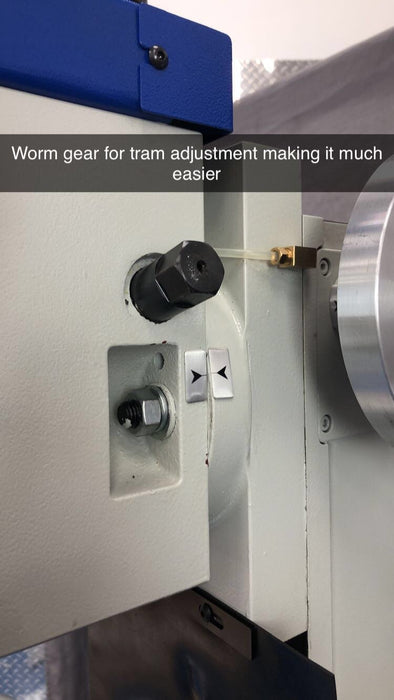

  • Worm Drive Gear for Easier Tramming of the Head
  • Enlarged Z Axis Column for Unmatched Rigidity
  • Industry Leading 5 Year Warranty

PM-728VT Main Features
Special Features that set this mill apart from others (BE SURE TO COMPARE THESE DIFFERENCES):
  • THIS MACHINE IS A STEP ABOVE ANYTHING CURRENTLY ON THE MARKET.
  • Ultra Precision Spindle, with Triple Bearing Support. Deep Groove Ball, and Angular Contact Bearings Run Precise and Stay Cool at High Speeds
  • Features a Worm Drive Gear for Tramming Head
  • Main Z Axis Column is attached to the base with 4 bolts, with a wide, proper mounting surface for much more rigidity over other models in this size range

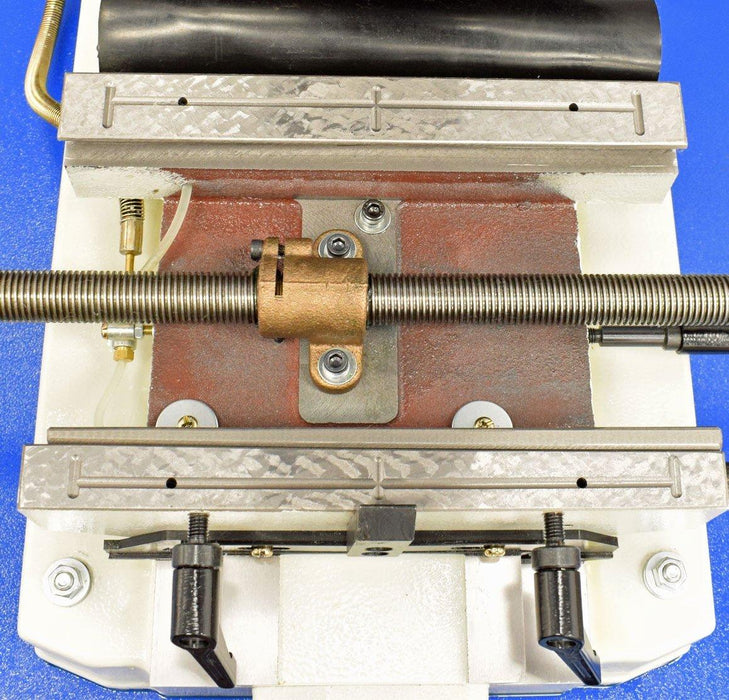

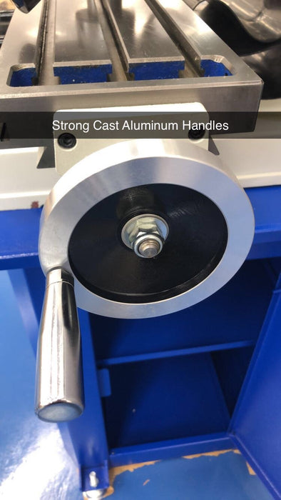

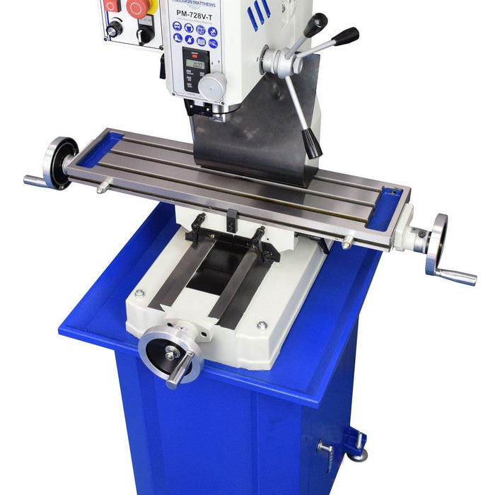

  • 0.001" Readings with larger dials on the X and Y axis, with true 10 Thread Per Inch Leadscrews make it easier to cut accurately - (One line on the dial is 0.001", one full turn of the handwheel is 0.100", much easier to use than those with odd metric conversions)
  • Highest Precision ground ways, With Mating Surfaces Hand Scraped To Fit for Much Tighter and Smoother movements - Ultimate High Precision Fit Of Ways and Gibs With This Machine
  • Thrust Bearings in leadscrew ends - not bushings - Much smoother movements and less backlash
  • Split nuts on X and Y Axis to allow for backlash adjustment

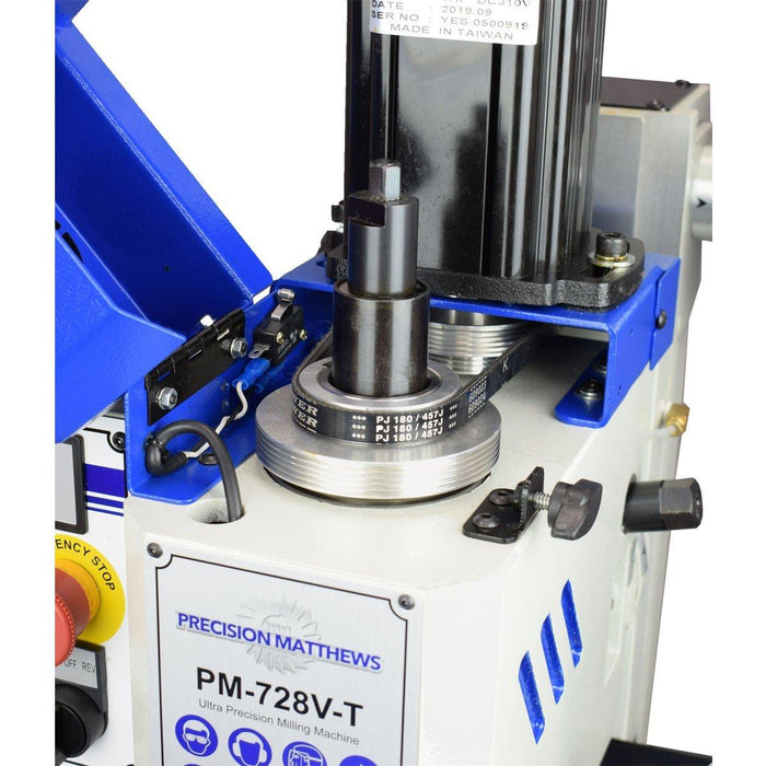

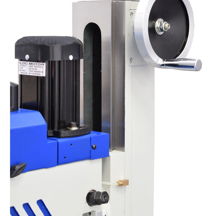

  • DC BRUSHLESS MOTOR, Variable Speed, POWERFUL, SMOOTH, and RELIABLE Belt Drive from Motor to Spindle runs MUCH quieter than others, and eliminates any failure prone plastic gears (And the hassle of changing them when stripped)
  • 5 Year Warranty, for added peace of mind

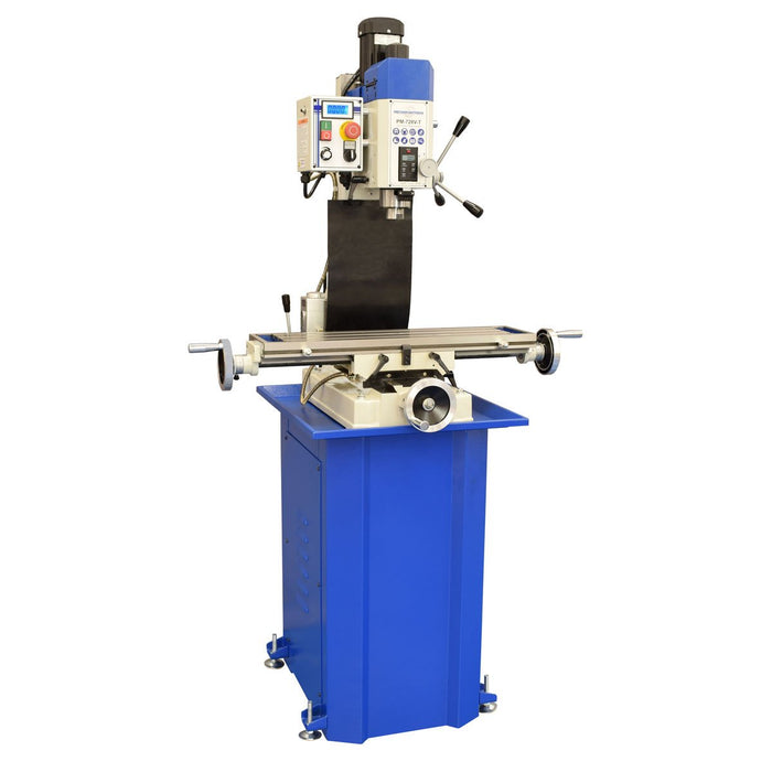

PM-728VT Standard Accessories
  • Chip Tray
  • Variable Speed with Belt Drive and Brushless DC Motor
  • Way Cover Set
  • Drawbar
  • R8 Spindle Taper
  • Quill/Spindle Depth DRO
  • Spindle Locking Wrench
PM-728VT Optional Accessories

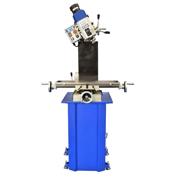

  • Stand with Leveling Feet

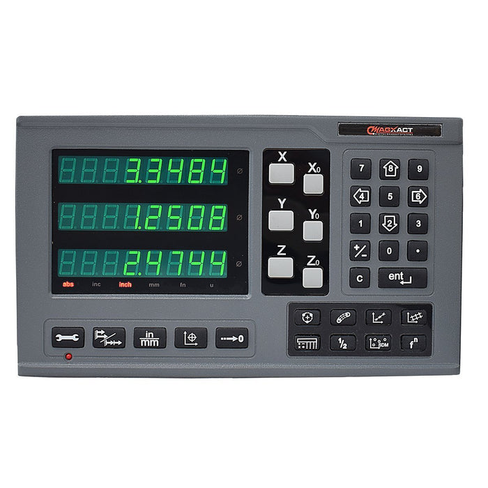

  • 3 Axis DRO Installed (Choose Either the Numerical MX-100M DRO, or LCD/Graphical MX-200M, both are Magnetic and use the same scales) Note: if a 3 axis DRO is added to the machine, the 3rd axis of the DRO reads the HEAD up and down, Not the quill, so it is not doubling up on the measurement. If you add the 3 axis DRO, now both Z Axis movements are covered, the head, and the quill)
DRO Choices:
MX-100M Numerical: MX-100M DRO
MX-200M Graphical: MX-200M DRO
Both units above use the same scales, the display is the only difference in them.

Headstock Tilt, Left to Right ±90°, with Worm Gear Movement for easier tram adjustments

DC Brushless
Infinitely Variable
75
4,000
