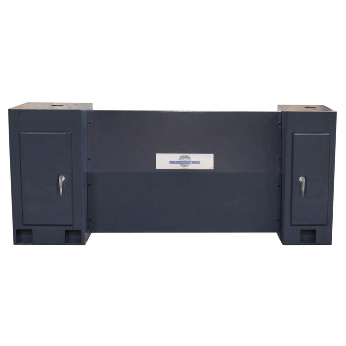

Stand is shown in some pictures, Stand is optional (As shown in selections)
