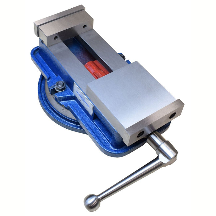

  • Extremely High Quality Vise
  • Hardened Bed for longer life
  • Thrust Bearings on lead screw
  • Made from Strong Ductile Iron
  • Precision Ground Surfaces to .0006"

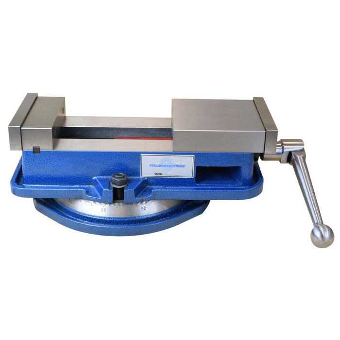

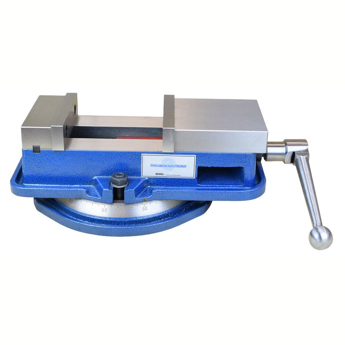

  • Complete with 360 Degree Swivel Base
  • Locking Mechanism with Downward Force to help avoid jaw lifting
  • Removable Jaws can be re-positioned to exterior for larger holding capacity
  • Can be used with or without swivel base
  • Swivel Handle Included
  • Hardened Vise Jaws, Material 65Mn Steel, Hardened to 50-60 Rockwell C
  • Jaw Width 5-1/4"
  • Jaw Mounting Bolt Threads: M10x1.5
  • Jaw Height Approx. 1.425" (bed slideway to top of jaw)
  • Max Jaw Opening 5-1/4" (inside position)
  • Max Jaw Clamping, 13" (Jaws on outside position, example: clamping a flat plate on top of vise)

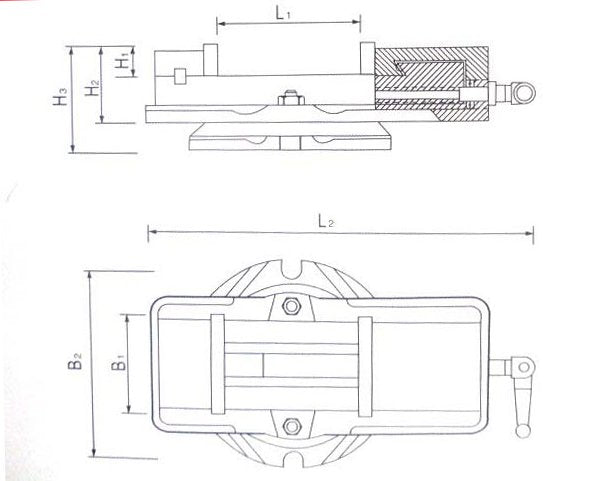

Measurements to match with drawing shown in photos:
L1 – 130mm
L2 – 430mm
B1 – 134mm
B2 – 247mm
H1 – 36mm
H2 – 98mm
H3 – 135mm
